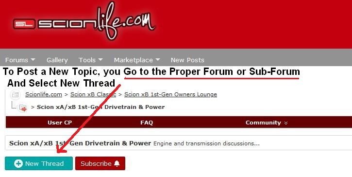

Also I'm new to this so how do I post a new topic or question?

Originally Posted by Wojtek
Also I'm new to this so how do I post a new topic or question? Thanks for your help
Hello Wojtek! Welcome to SL!
Looking forward to see you in:
Scion xB 1st-Gen Owners Lounge (2004-2006.5)
Please Check out the informative Stickys above in the Header of this Forum HERE.
Sticky How To Advanced Search SL (Scion Life)
