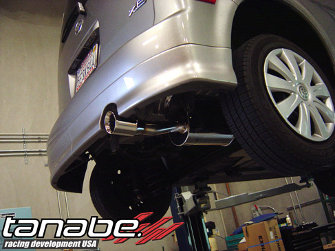

What about the Tanabe exhaust?
this looks like it has decent clearance. i called a local shop and they said they carry these. also the guy there has a r3.0 as well and he said it sounds nice.

I'm still leaning toward the Borla...just becuase of the fact it's got the same style oval tip I have now, which isn't as large as the round of the Tanabe.
