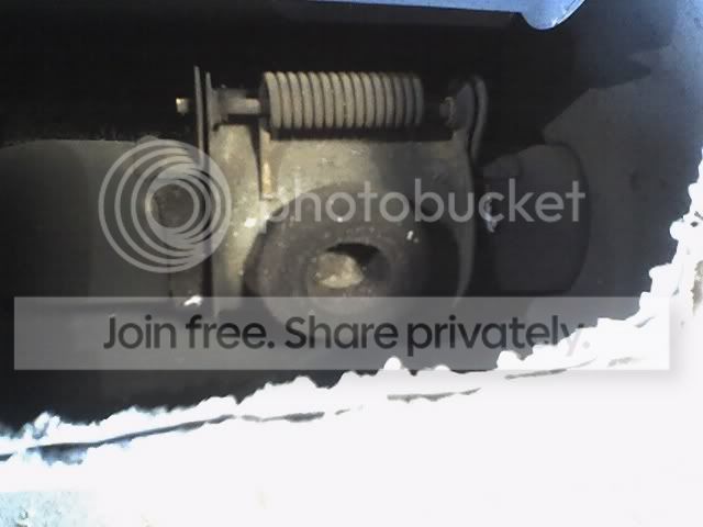

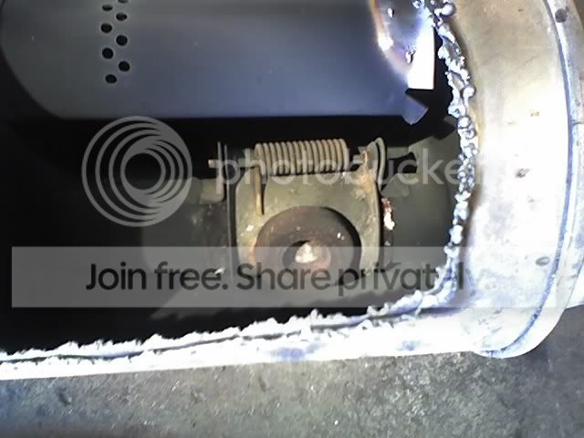

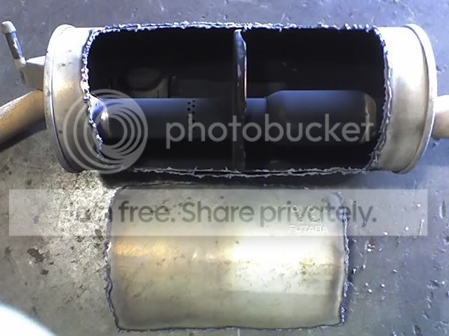

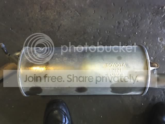

Here are some pics of the valve in the muffler that has been talked about.
This peaked my curiosity so I cut my old one open. This is off of an 06 xa.

oh thats very nice
have you moved/opened this valve with you hand and how hard/easy is it to be moved open?

It's fairly easy to open. You could do it with two fingers no problem. The chamber opposite to the valve is a dead end so when your exhaust comes into the mufler, through the valve and into the second chamber is just builds pressure there till the valve opens. It looks to me like the valve would have to be open anytime the engine is running just at different levels.

In the usual scenario, as exhaust volume goes up, so does backpressure... the valve helps prevent that, keeping the actual pressure in the exhaust system more constant at any rpm... with excellent noise control at idle and moderate throttle settings...
Ultimately, the spring will fatigue or break - has to be some remarkable metallurgy involved, considering the temperature range involved...
