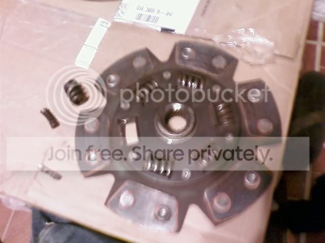

welpz after a year or two later this is what happened to my clutch after aggressive driving and running touges with alot of heal toe....
my pressure plate is messed up too....it was a Stage 4 clutch kit for Competition Clutch.....i also need new shift linkage cuzz my headers burnt threw on cable and it ripped apart after trying to force the box into gear.......so in turn i ordered a new clutch kit, throw out bearing, and shift linkage.....puts me at about 400 big ones give or take....there are a couple of other springs that were also close to breaking but it just takes one right........
