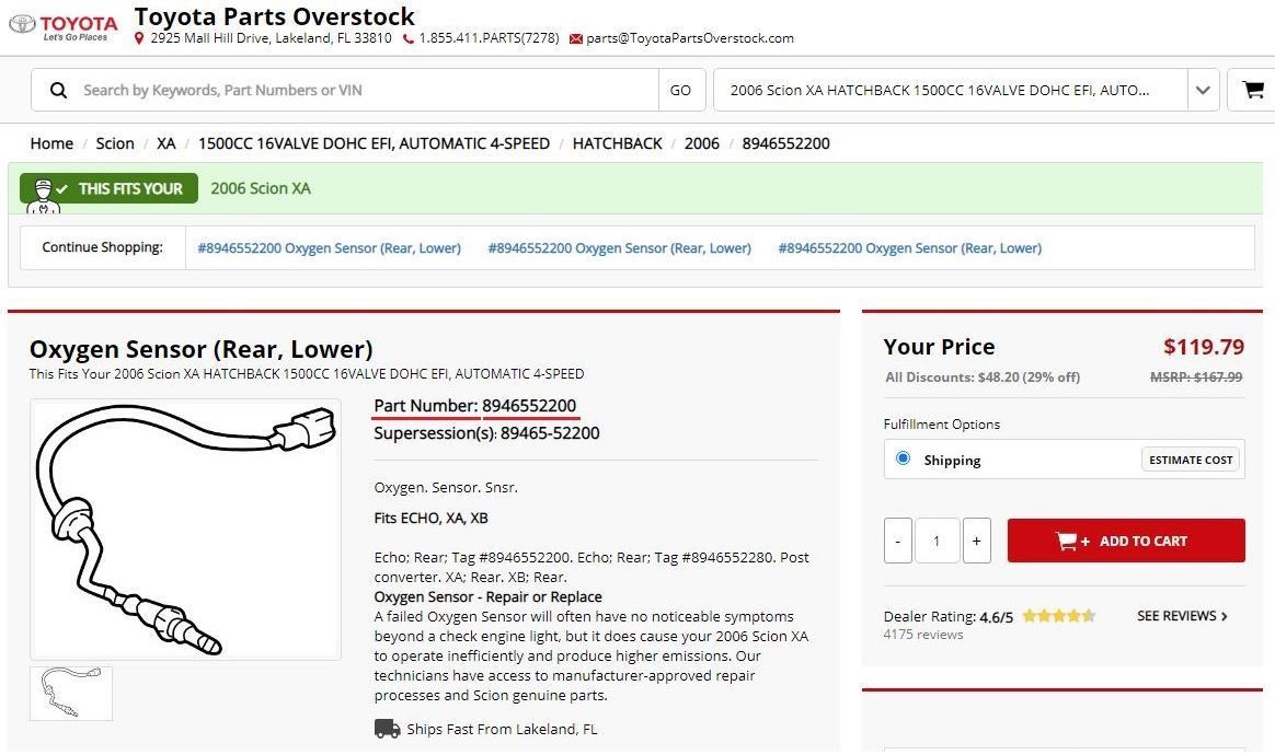

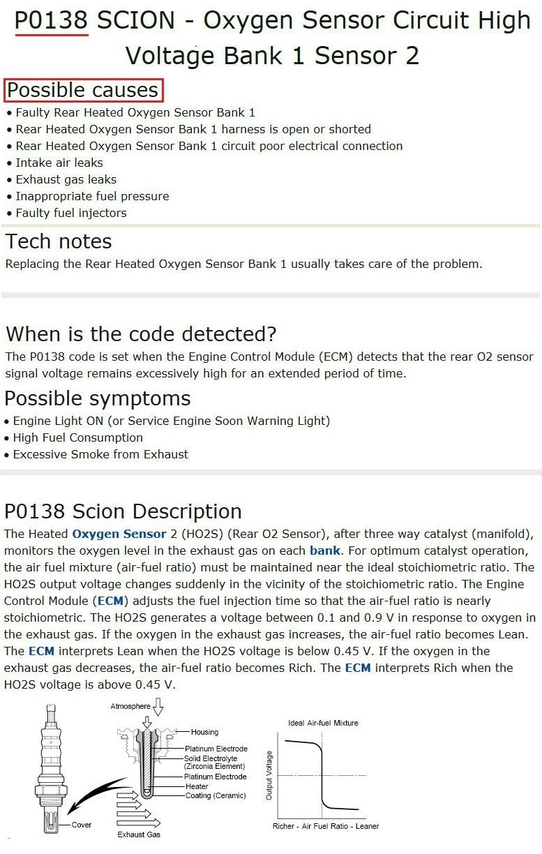

The Bank 1 No. 2 Oxygen Sensor is located After the Catalytic Converter towards the muffler/resonator. The No. 1 Oxygen Sensor is in Front towards the Engine.
If you determine, the Oxygen No. 2 Sensor is faulty, as 2stroked suggested just replace it. Don't employ cheap fixes that you will regret.
I Do Not Recommend using inferior eBay Parts on my Vehicles. If you want Toyota Quality, I use Only Toyota OEM Parts. Costly, but well worth it.
