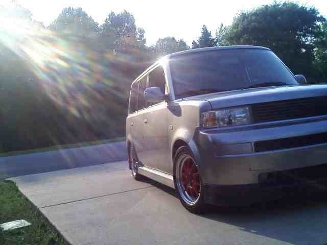

The TRD springs are a great idea but u will probably want to go lower if u run 15" wheels. They just have too much wheel gap. I went with dropzones which fav me about 1.75" at first and now have settled to about 2". I'm still running stock shocks/struts but want to go with the koni front struts for the echo and possibly the gr2(?) rear shocks. That is unless I go racelands which will give about the same drop I have with new shocks/struts and more travel if you leave in the helpers. recommended intake and exhaust setups?-imageuploadedbytapatalk1338318766.648563.jpg
