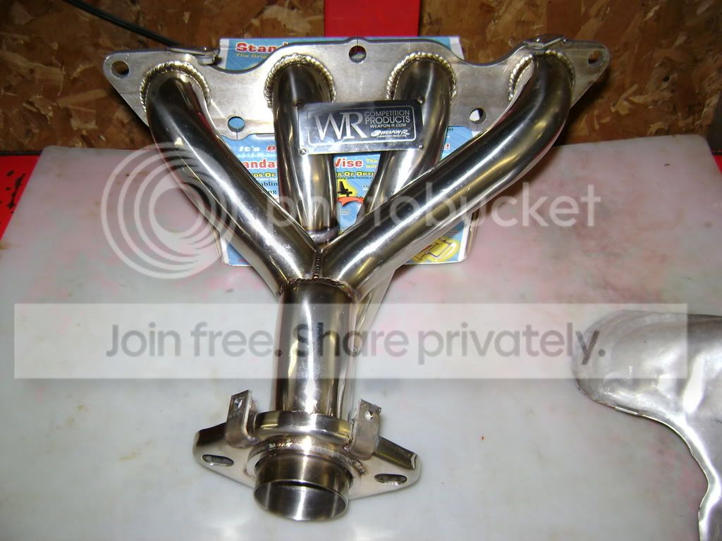

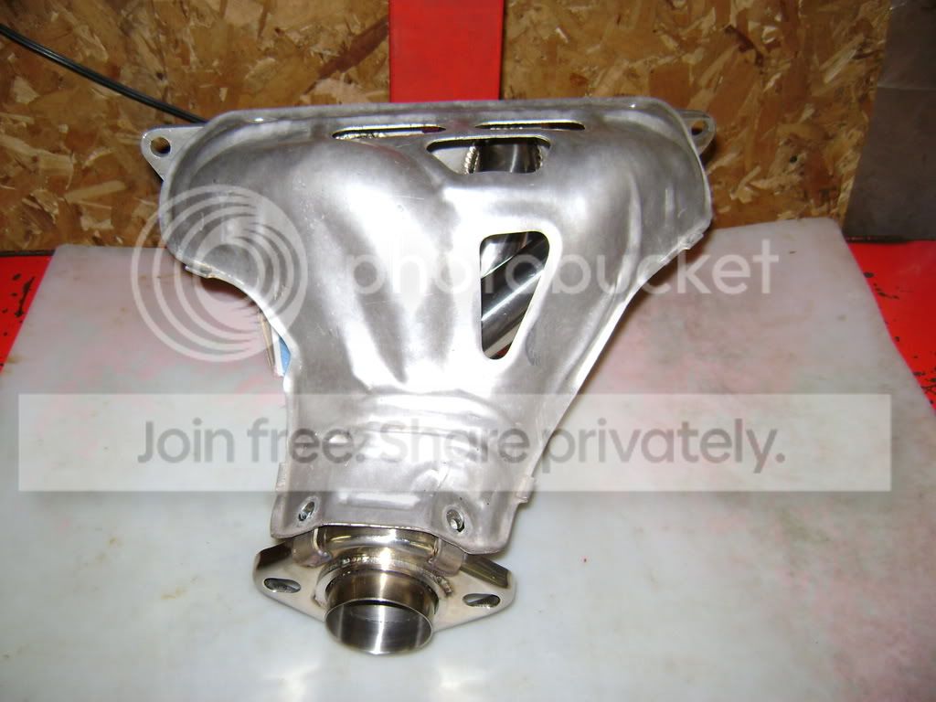

I finally installed the MMW header. I had tabs and bolts welded on, so the stock heatshield could be retained. It makes for a nice deep tone out the back of the 2" custom cat back. Instant torque, and pulls nice. Total $ in complete exhaust, from tip to header, 490.

No, they dont. Its real easy to do. Lucky for me my welder cut me out some 1/8th in stainless plates and I drilled em and cut em. I also have the 6mm nuts. I took it all back over to him, and he had it welded up in less than 10 minutes. Had I known this ahead of time, I would have gone for the OBX 4-2-1 header, since they look almost identical. Oh well, its done.

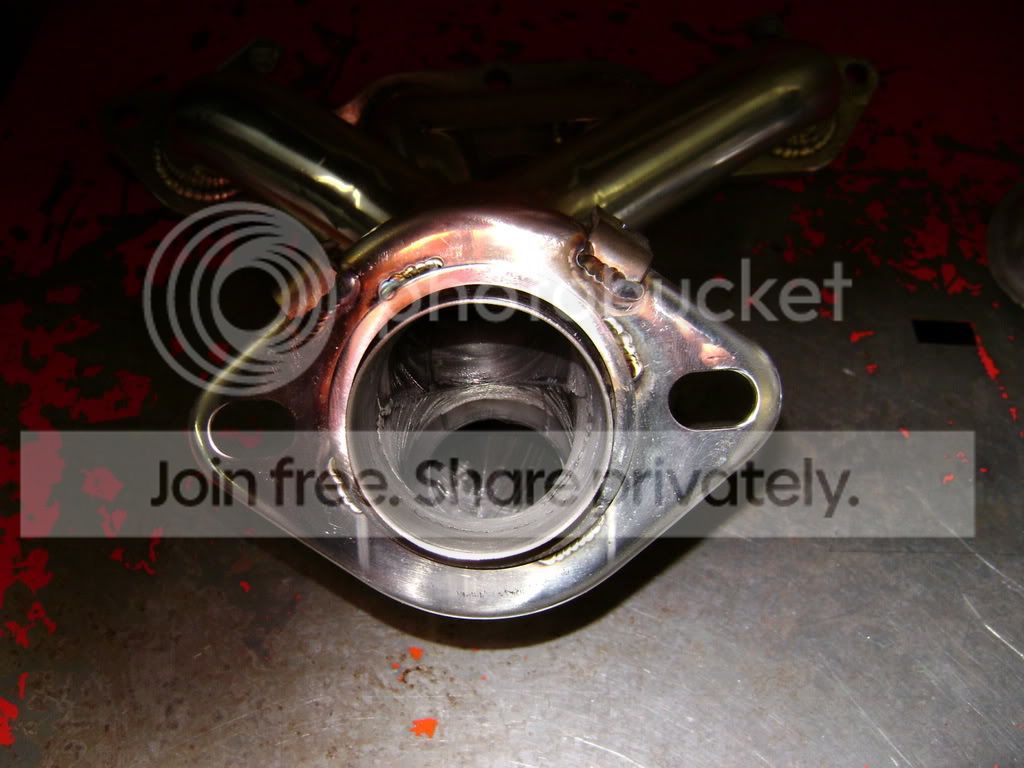

No its not, that was the biggest pia, putting those two exhaust nuts on, I needed another set of hands. Id have saved a few bucks and went with the OBX 4-2-1 had I known that. Too late...
