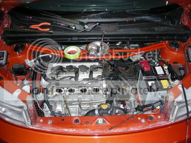

On a 5spd too!
Yeah i've had that damn thing for over a year. Tried to sell it.
Couldn't find any takers, so.... I said F it!
Took about 6 hours, Probably about a 8 out of 10 on my personal difficulty scale.
I'm pleased with the results.
Adds alot of Torque in the Low to Mid RPM range. No major issues yet.
Few minor ones.
Belt slippage, mostly.
Before:
During:
After:
Took those pics the day of, have sinced added a WR Engine Dampener.

As an update. I added a Weapon R Engine Dampener, put it on last night.
Honestly I can't tell that the dampener makes much of a difference when I drive it, but maybe i'm confused.
I also tightened up the other belt, the squeal at high RPM has gotten better, but it still rears its ugly head above 6k. Not as bad as it was before (above 5k).
Red line is 6500 isn't it? so i'm not losing much shifting at 6 right?
The engine dampener was nothing like what I thought it would be. I assumed it was a shock of sorts, but its just two peices of really firm rubber on either side of a piston.
So basicly its a shock with no gas/oil/air inside, just the bumpstops. Strange.
It does create a little tiny bit of engine noise inside. Hardly noticeable really. Nothing like the reports I had read/ (misunderstood) on here.
Anyway, thats my latest report.
Hopefully this week my e-bay intake will arrive, and i'll get some S/C whine out of that....
-TR

did you only have to take that front grill off in order to install the SC if so that is quite impressive I thought it would be a more elaborate installation then that. Not saying that it is easy but it is definately not a turbo.
Also what does that hose go to that is connected to the SC, sorry i am not very familiar with forced induction.

You have to remove the grille and the upper tie bar of the radiator support. It gives you all the access you need. Its real simple, jus tfour bolts after you remove the grille.
That hose goes from the intake manifold to the actuator. Just shows pressure to the actuator to let it bleed off.
