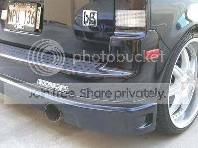

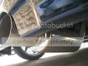

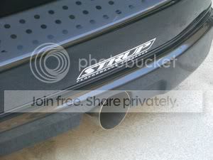

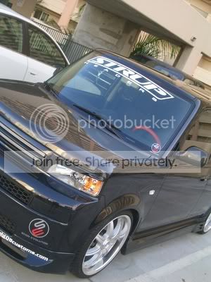

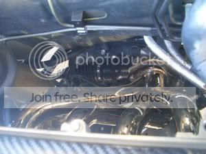

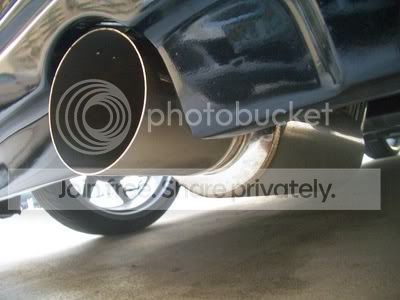

HEy guy i distribute in hawaiif or strup.. here are somepic of the version 1 the only diff with the new ones is that it dosent sit as much as in a angle and it sits higher so you dont hit speed bumps..

is the strup straight up bolt on or weld? bc the pics of the exhaust on most sales sites dont show it

all axle backs for the xB are bolt on.

i was just going by the picture bc it doesnt seem to have any holes to bolt.. like most exhaust systems im referring to the piece that you bolt together and put the gasket in between that looks like a lemon.... i dont know the correct term.

it uses a clamp to connect the b-pipe and the axleback, a gasket goes in between the pipes.
No welding, just one clamp to tighten up.
