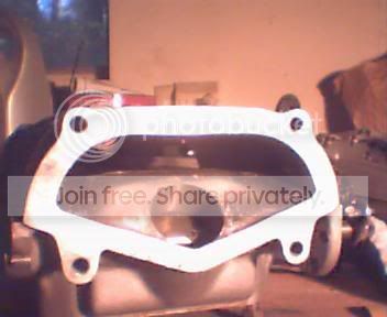

here is what i have so far, sorry for the poor quality of the pic, i had to take it with my web cam, loaned my camera to someone for the weekend...
gives the idea anyways...

Easy, there is an oil impregnated coupler? And they do get noisy, all of them. Throttle Body http://www.extrudabody.biz/servlet/StoreFront

here is a link to the coupler... http://www.zzperformance.com/grand_p...=155&catid=106 ...i think the usual milage where the couplers begin to wear is about 50-75k... still a long ways off... driving habits, im sure, will lengthen or shorten the life... anyways, easy fix if it ever does happen...
