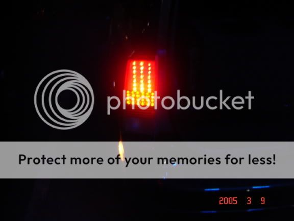

You might need to get some resistors tapped to your wirings. You can go to Radio Shack and pick up 2 6ohm 10v resistors and wire clampers to add more load to the LEDs. Same thing happened to me, we converted my brake lights and turn signals into LEDs and they blinked twice as fast so I tapped both sides with resistors and now it blinks normal.
Here's a pic of my LED Tails:

Cool tail lights!
