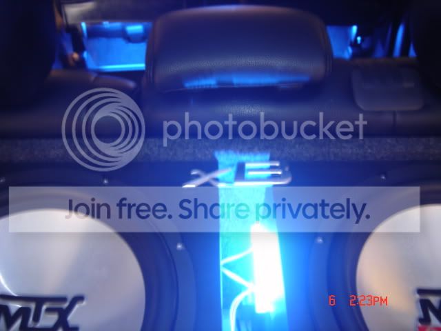

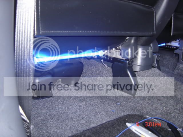

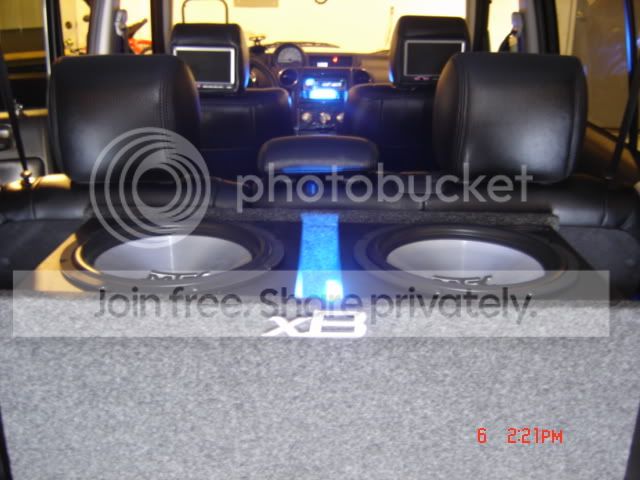

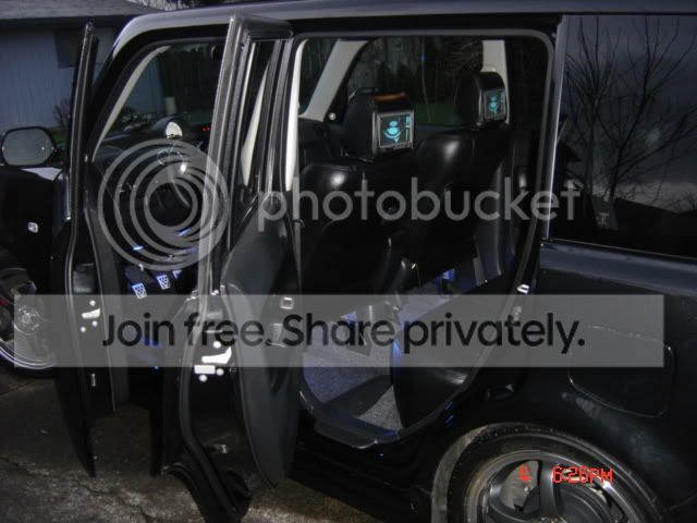

here is my cold cathode ligting from oznium I just install the this morning I have 12'' under dash and under seats,, and 4'' under my alpine , and here

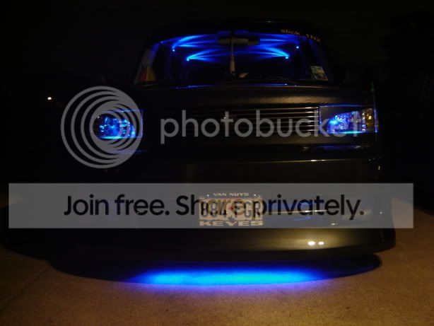

I haven't tried the 15"s which I think it's too long. I've used 12"s and 4" which were easier to work with.
Here's where I used the 4".
Old Feb 9, 2006 | 01:36 AM
trainman0978's Avatar
Posts: 229
From: Georgia
now that is cool as h-e-double hockey sticks.
Old Feb 9, 2006 | 01:50 AM
Scott17's Avatar
StyleWagons
Joined: Mar 2004
Posts: 1,459
Third World strikes again!!! That roof lighting is sweet!
Old Feb 9, 2006 | 02:17 AM
stick_1NZ's Avatar
Joined: Apr 2004
Posts: 3,993
From: Abra, Philippines
it's all the ideas you had put under my sleeve......
Old Feb 9, 2006 | 02:26 AM
Scott17's Avatar
StyleWagons
Joined: Mar 2004
Posts: 1,459
It looks like someones playing laser-tag in your car!
that looks bada$$...your box always looks sharp

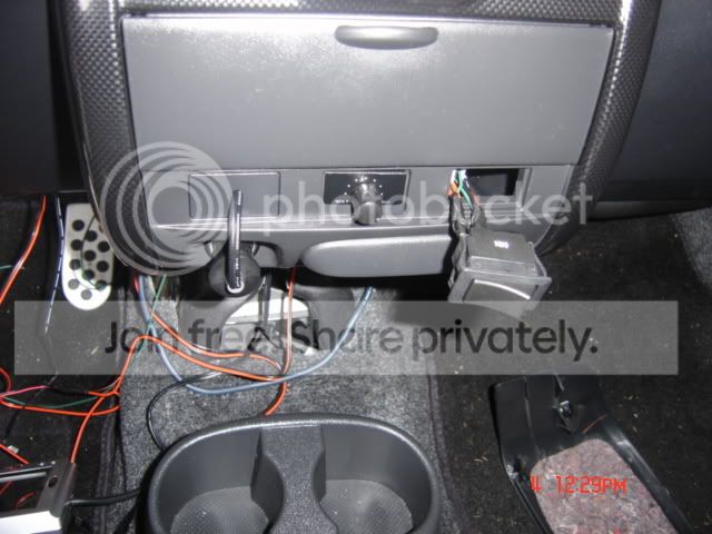

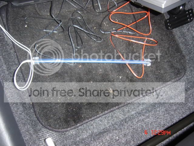

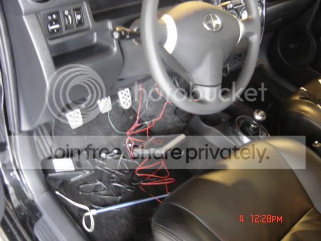

I finally got my inverter to work and now I've got four 12 inch blues in my engine bay. I also have a _____in' home made ghetto switch....
And last but not least, my home made super duper ghetto switch.
Old Feb 11, 2006 | 09:28 PM
Sciond's Avatar
Posts: 14,929
From: What's in your Box...
hey it works....and looks good...what else matter!
