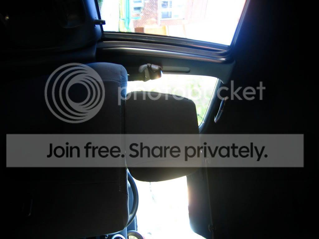

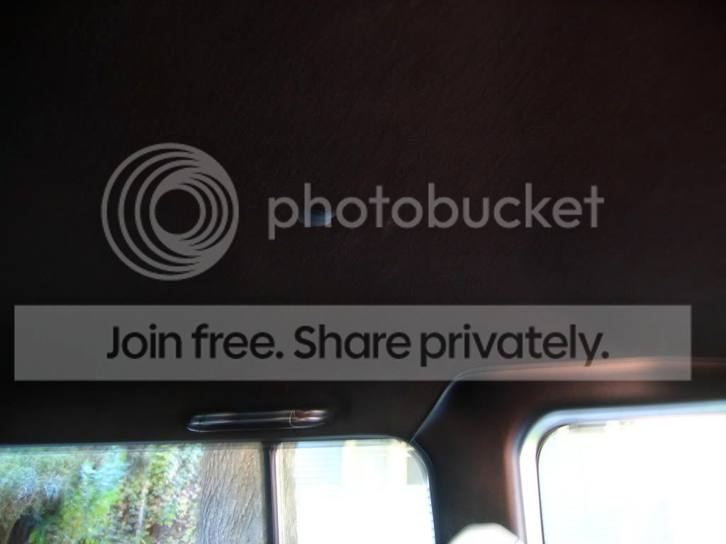

So I finally went through with it and blacked out my interior.
Here are the pics, they're a bit blurry since the flash causes the headliner to look washed out. So this is a pretty accurate representation of the color. I'm pretty happy with it. Opinions?

looks pretty dark in there, kinda like a cave. looks good though!

That looks a lot better than I was expecting. Nice work.

Duplicolor vinyl/fabric.
It took 8 cans to finish it off.

Yea... it was kinda guess and check with the method, but as far as I can tell, you're better off using super light coats and keep building on it. I think it's a bit trickier for the dye to set since the headliner is a synthetic fiber. There might be a better product out there (I've actually heard that Krylon Fusion will work) but the end result is just fine.
I'll update if I start to see any unusual wear, but right now it seems pretty bulletproof.

I left the headliner in my basement for a few days. There's a bit of odor left on it for about a week.
As far as the number of cans... that's what I needed to get uniform color. The xB headliner is massive compared to a tC one.
