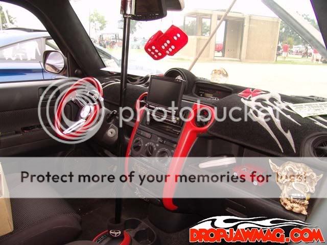

I got the aluminium shifter extension from ebay. I made the adapter to connect the shifter to the extension out of a piece of stainless steel i found at work. Painted it all hammered bronze and put a vintage Miller high life beer tap handle on top. Any questions just ask.

Now that is an extention!
I would have made an adapter if we had the right tap, but no luck. So I just bought 3 nuts and locked it in, and the nuts are hidden inside the shift ****. I still might make an adapter, for better thread engagement.

mine is simply a 1/2 inch PVC pipe I picked up from Home Depot and a aluminum rod from there as well that will fit down into the stock shaft. cut both of them to size and all you have to do is push down to unlock the shifter. That is a Dr Pepper car at the top to fill in th gap under the shift ****.
