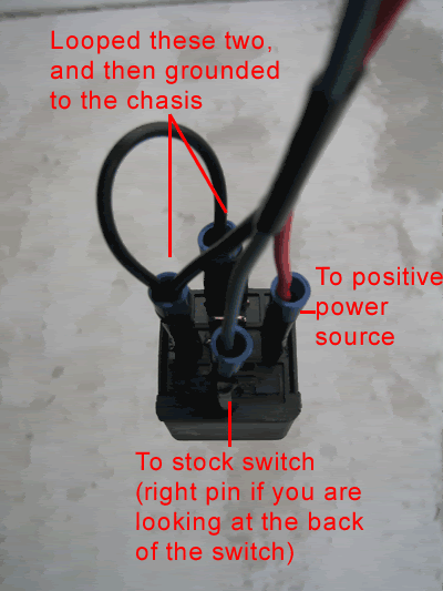

I rewired the fog lights. I used Inazuma's schematic (Thanks Inazuma!), and used a relay. As opposed to using a positive source from the ignition, I opted to use the parking lights as my positive source. So now as long as my parking only, or headlights are on, my foglights can be turned on or off, regardless on whether or not the car is on. I opted for this wiring since I didn't intend on driving with the fogs alone, and the parking/headlight reminder will chime if I turn the car off with the lights on.
Here is a link to Inazuma's instructions:
http://members.***.net/inazuma/fogs.htm
Here is a picture of my relay:

Do you still need the relay in the fuse box this way or does the relay in the pic take it's place?
Old May 21, 2005 | 06:33 AM
etarui's Avatar
Posts: 215
The relay is in addition to the existing one.
