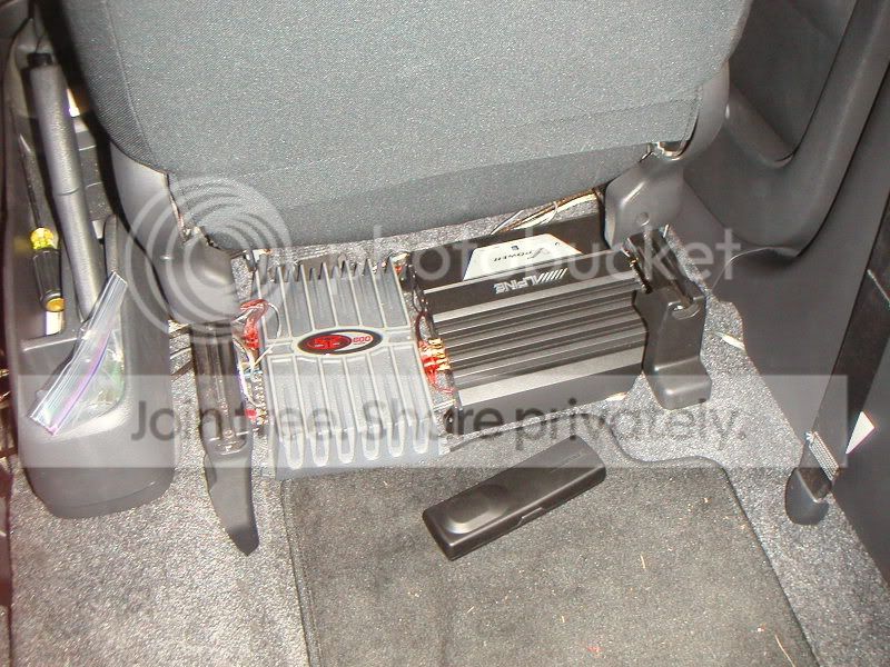

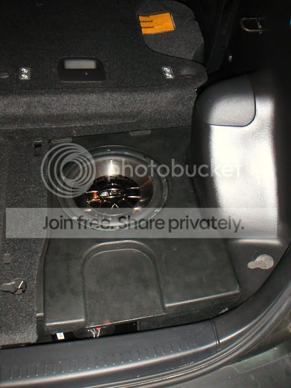

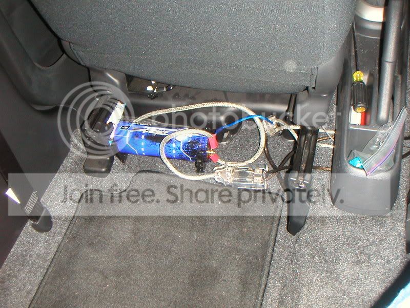

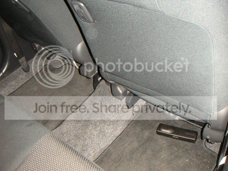

Here are some pics of the install. As you can see, I did it a bit sloppy and definitely have room to make it even more unnoticable.
Seats back to normal position:
AMPS:
Cap and Distribution Blocks:
Scosche Box

Does the cover go back over the enclosure to hide it?

thanks for the pics. Very scary install though.

You might want to try and re wire that befor you fry somthing.... Or you push the seat back and pinch a wire and arc it and start a fire.. Good luck

Who did the wiring? Stevie Wonder! Pleases redo the wiring before you start a fire.

To answer the question about the lid, yes it goes on to cover the enclosure completely. If someone were to lift up the back mat I have in the trunk and see the two lids, they're never know there was a sub.
As far as the wiring goes, I think you all are right. I will re-wire it and make it safer. Thanks for the help guys!

You should stack your amps under the seat, instead of side by side. Use some silicone anti scuff pads on the top amp to give some distance between the 2.

Where can I find these pads? I was originally thinking about a wood frame but I don;t have the tools to make that happen. Any other suggestions?
