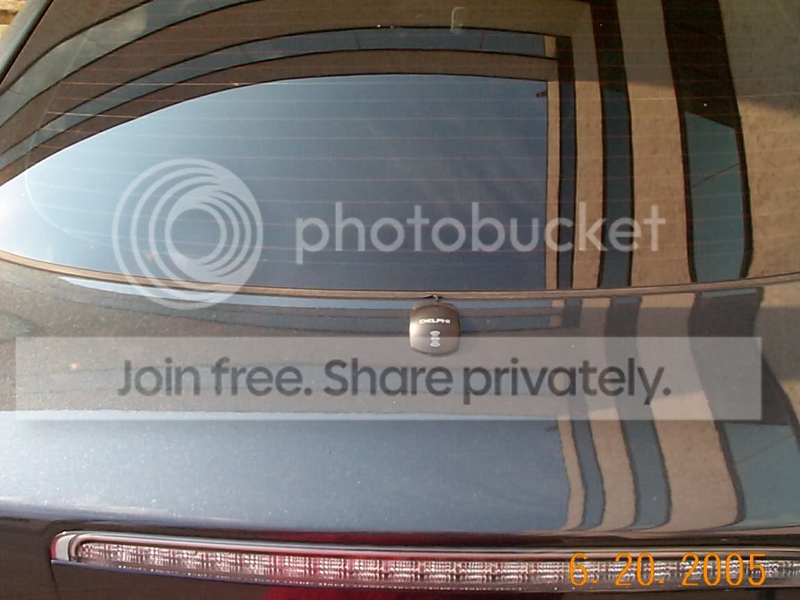

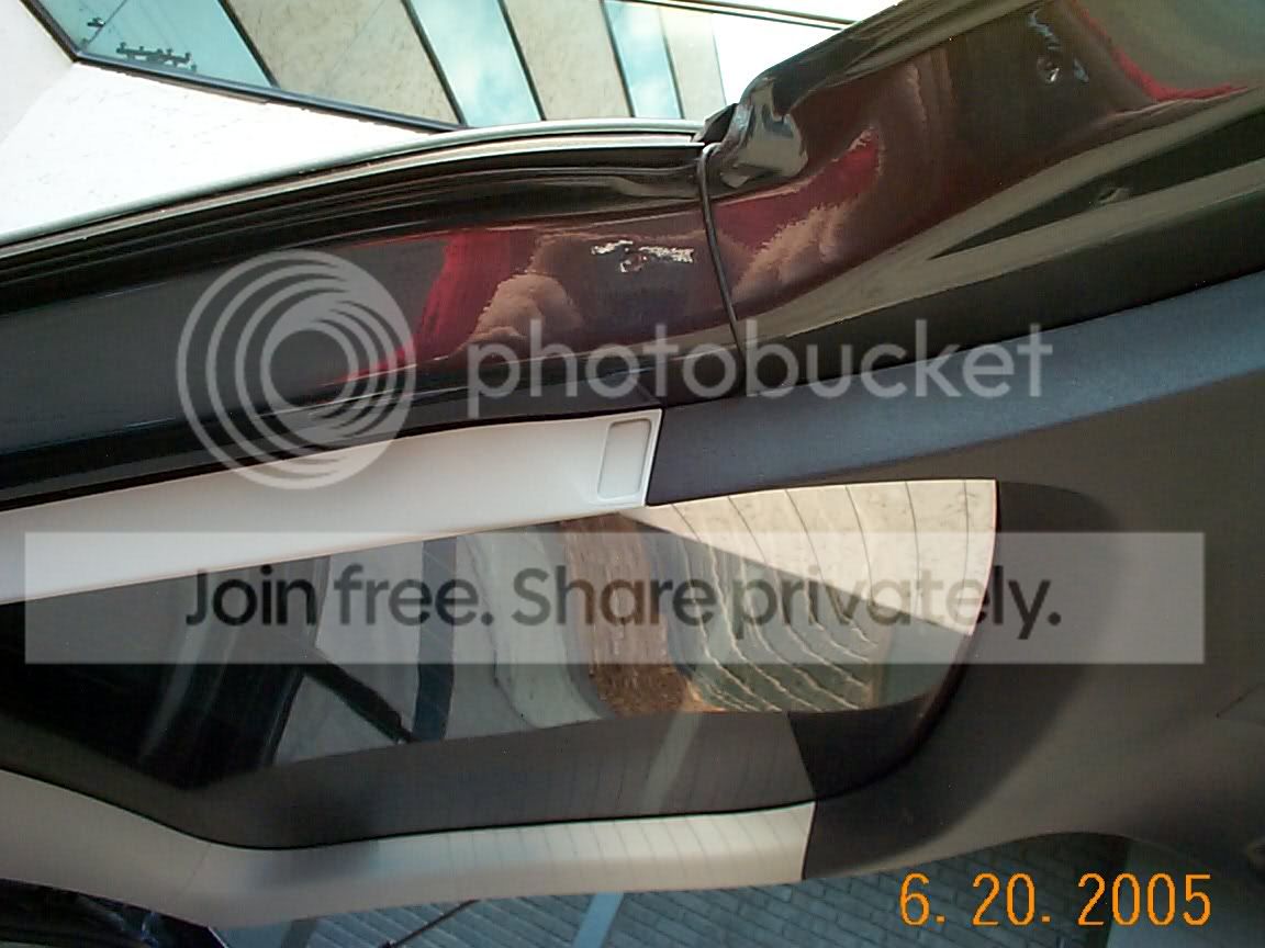

ok i work for circuit city so i have plenty of experience with running the antennas. I mounted my antenna on my hatch at the base of the glass in the middle, pulled up the edge of the rubber seal and ran it along that to the driver side and then went into the hatch and under the plastic hatch panel up to the top. then went under the seal and down the the interior and along the piece that seperates the roofliner and side panels. if i get a chance i will take some pics cause i need to take some pics of my stereo setup.

Here you go I hope that this might help you or anyone
