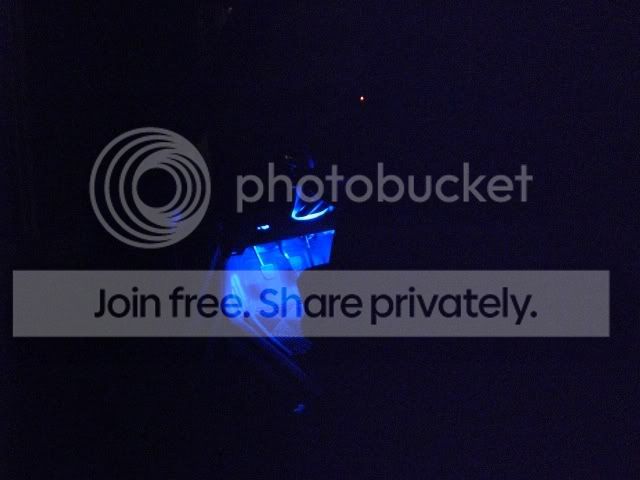

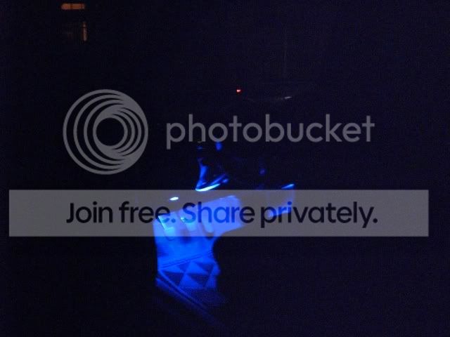

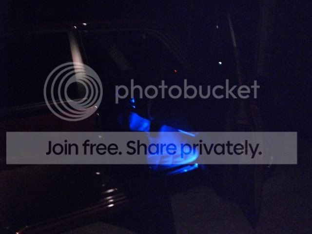

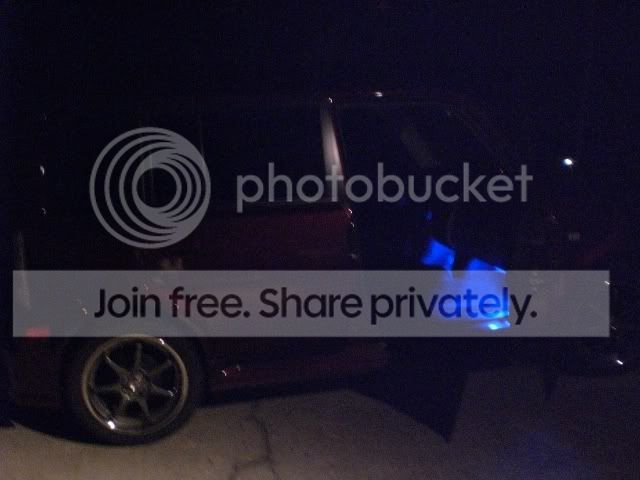

I like these alot!! They have a cool deep blue color when you actually see them in person...and as for the 30 minute install...hahaha yea right took me about an hour and half for a pretty clean install in my opinion. but ne way here are some pix.
