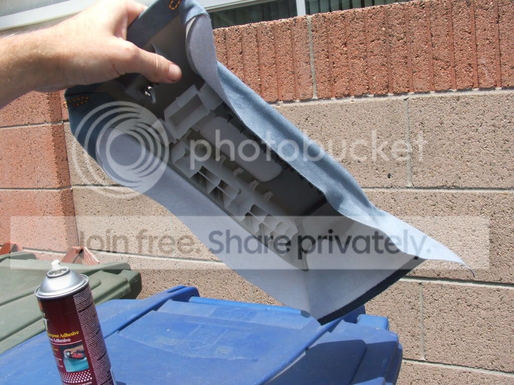

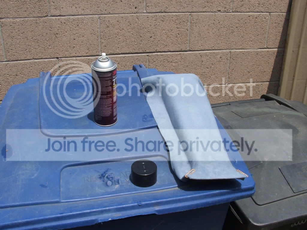

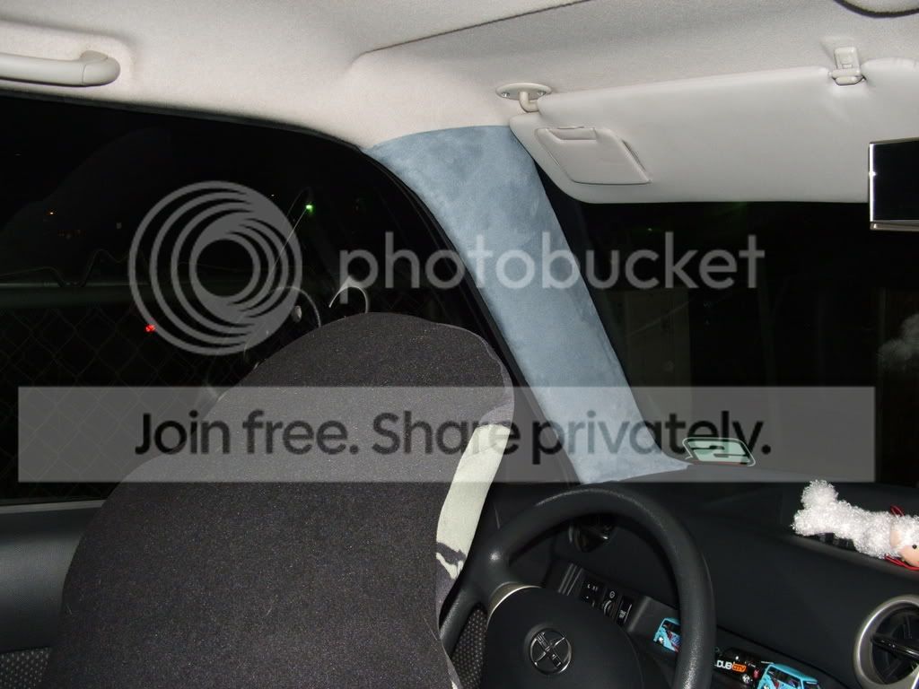

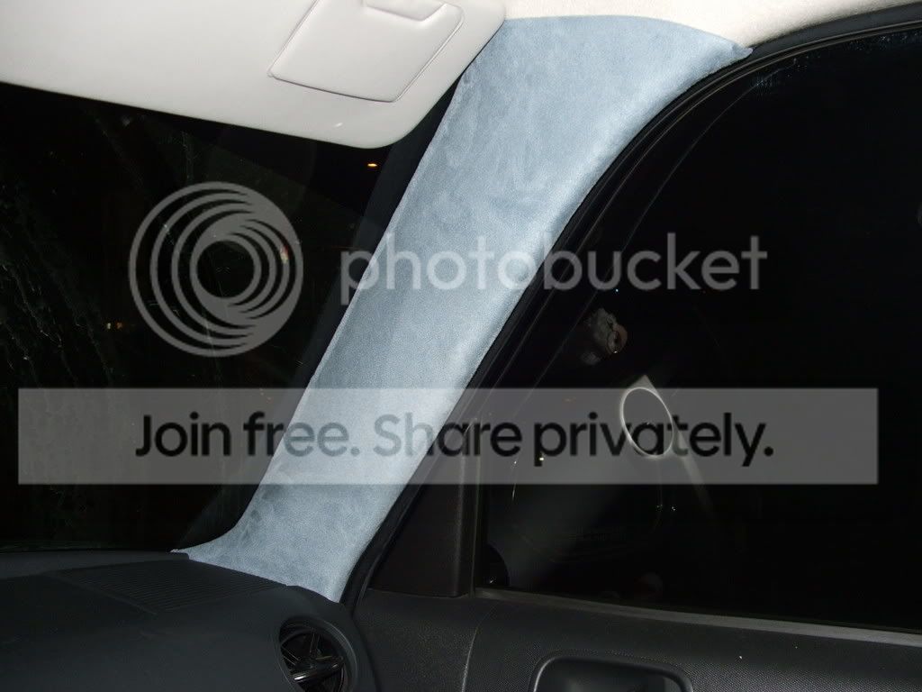

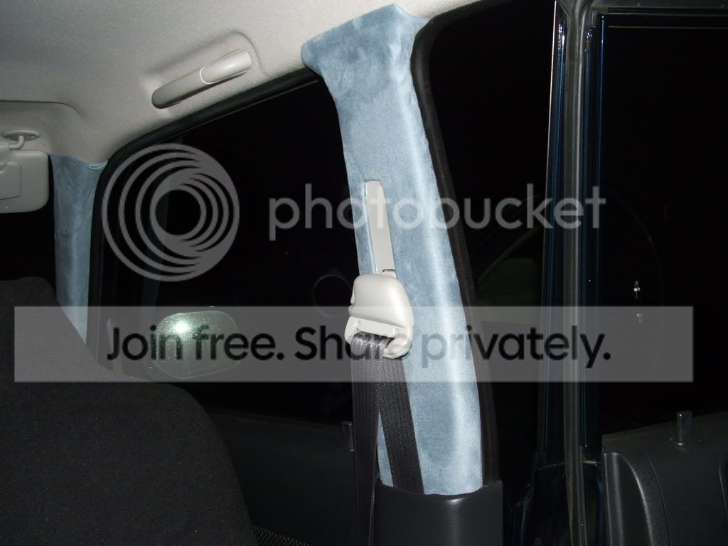

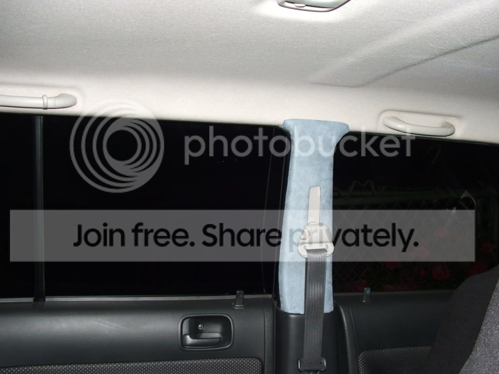

Alright...Ive strung y'all on long enough...first batch of pics.
The Prequi l to wrapping.
Front Pillars.
Center Pillars

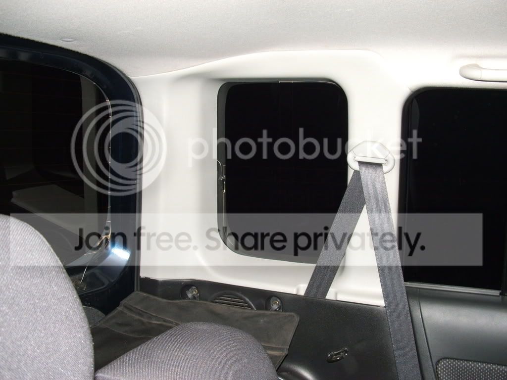

And the Unfinished REAR Quarter Pillar.....I dread doing this one, as it has the large window hole to work around, its not going to be fun, trying to get this one...or its opposite twin done.
Hopefully the pics arent too big, bad..or fuzzy. Lemme knwo how they turn out.

Do you just leave the extra on or do you cut it off? and if so how much do you trim?

use a big square piece for the rear quarter window then cut the center out and go. easiest way I can think of.

I cut most of the extra off, but allowed about 2 inches of it (to be tucked...in case of stretching issues of movement.
Its a good idea to have alot of like alligator clips, because the damn paper clips I used kept popping off..and rubber bands leave creases (that was another bad idea) oh well live and learn.
