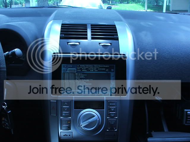

Or you can use this http://www.mp3car.com/store/product_...products_id=67 - if your not comfortable with running wires, this one plugs into the lighter socket and will auto start and shutdown your PC http://www.cartft.com/catalog/il/445
Here is a pic (bad one) but a pic none the less of my carpc

okay that is SWEEEET . . . can you give details on how you got it in there, and how about booting up - does it take a long time or what? i WANT ONE now!!!

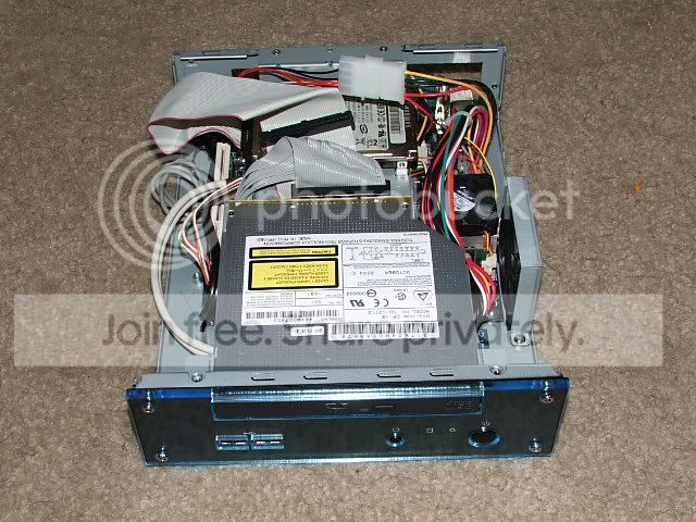

The screen is a 7in touchscreen xenarc, In order to make it fix without cutting the cut up itself, is to remove the black panel that is on the back of the AC controls. This will give you the needed clearance for the bottom of the screen. After that you just find a method to keep the screen in plcace. I used a hinge from lowes. My XP boot time is about 30sec. I used a program calling nlite (http://www.nliteos.com) to remove uneeded files from the windows OS, which cut down on the boot time by leaps and bounds.. I never see it boot anyhow I have a remote start, so once the car is on the PC auto boots. By the time i get to the car windows is running. Here is a pic of the PC itself, about the size of a text book

Is there anyway that you can show me the back side of the panel so I can see the hinge and how its keeping the screen in place. It would really help out.
