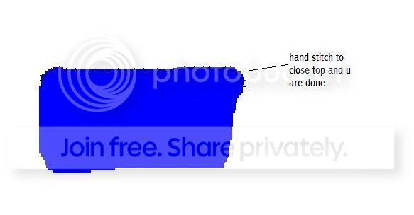

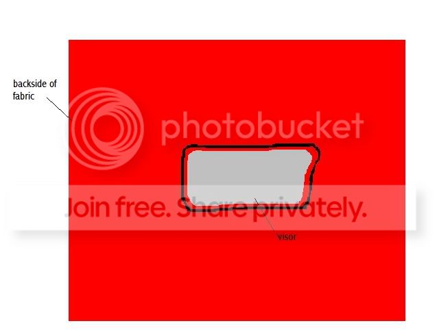

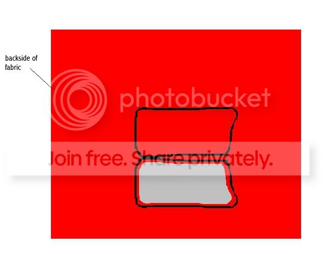

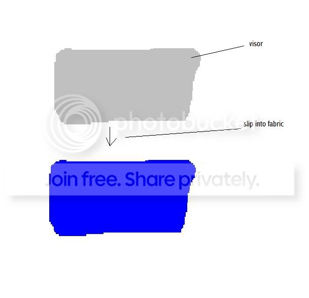

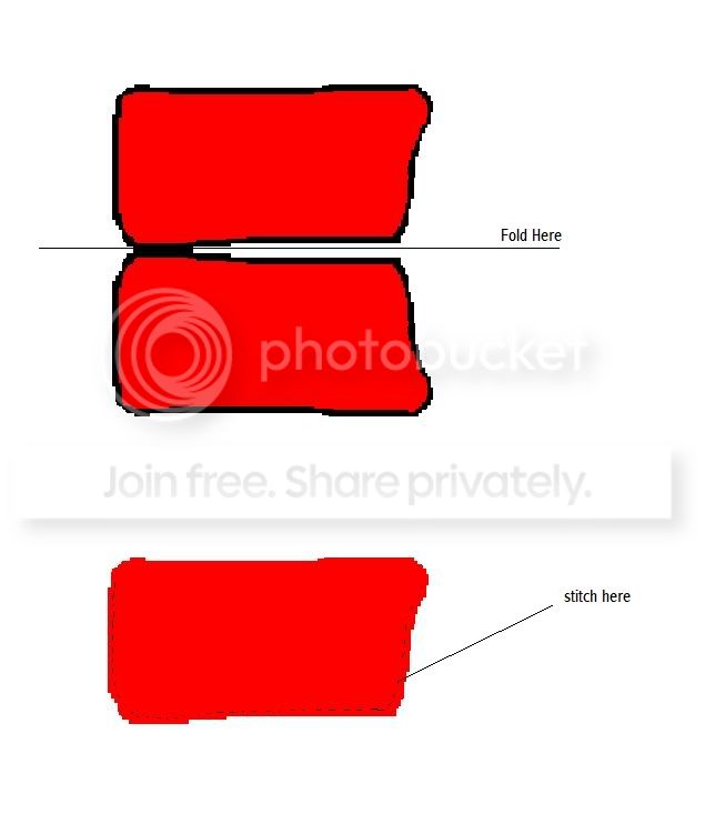

i made a slip cover out of the fabric i used on the headliner to cover my visors....
just trace ur visor on the back of the fabric
then flip the visor and trace it again
then cut it out, fold it, then sew the sides and bottom
then flip the fabric inside out so the side u want showing is showing and slip the visor inside the fabric
then hand sew the top of the fabric to close it up
and u are done....hope it helped
