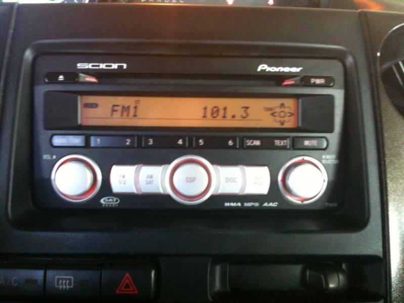

i got my hands on a second gen scion cd player for free this evening, took out the old one and replaced the mounting brackets and installed it in and everything works perfect except the aux will not work. im guessing this is cause the are in a different location in the first gen as opposed to the second and most likely is different in the wiring harness cause of it. has anyone else tried this before and figured out a solution? im going to be getting the ipod cable and hooking that up anyways but i would still like the aux port for anything else i might want to use

they changed the aux and ipod wiring in the 2008... instead of two separate harnesses like before that's prewired into the car... they combined them.
probably the cause of the issue you're having.
