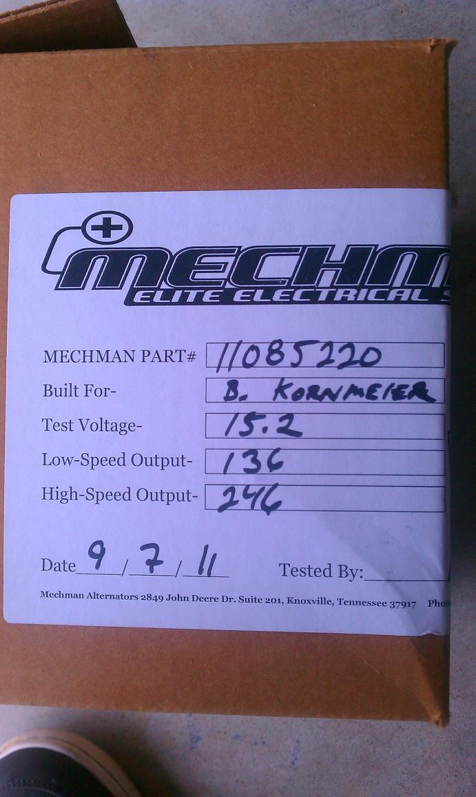

I have a 220A Mechman in my 05 xB. I installed it just before I deployed and it works great. I still need to fine tune the belt alignment on it as the belt is wearing premature due to it being slightly off. It squeals at startup and I just didn't have time to get it properly adjusted before I left. Not a big deal but I do have a constant 14.4V - 14.7V at full tilt with AC on, both sets of HID's on, and system up loud. I can adjust the output voltage on it as well. As you can see from the pics it is much larger than the stock alternator.

I had to get a slightly longer belt too when I installed mine. I used a Gates Micro V-AT belt. I don't know the model number on it. But I will be getting another belt when I get home from this deployment. Like I stated in my other post above it is not adjusted properly at the moment and has caused pre-mature wear which will eventually lead to complete failure.

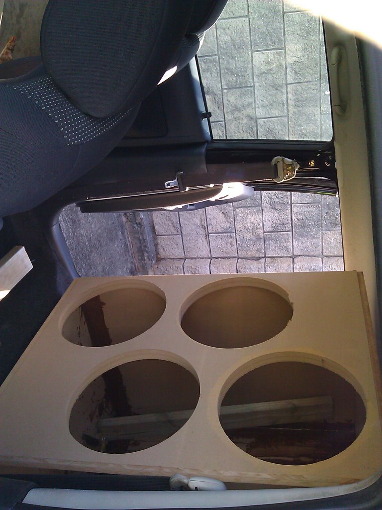

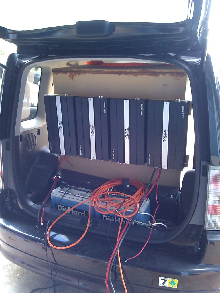

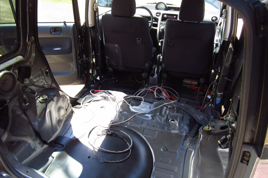

Hey guys, sorry for the lack of updates, its been really busy lately. Anyway, I got it all walled up, it did a 151.5 @ 35Hz on a Termlab, at the dash, windows up, etc.
I got the alternator in today, but installing this is the biggest pain in the ___ ever. Anyone got pix of it installed? I assume the washer go on the bottom bracket to shim and align the belt, but where does the large black spacer go? The adjustment arm on the block doesn't line up with the top of the alternator. Perhaps I've done something very wrong.
I'll try and get more pix up later!

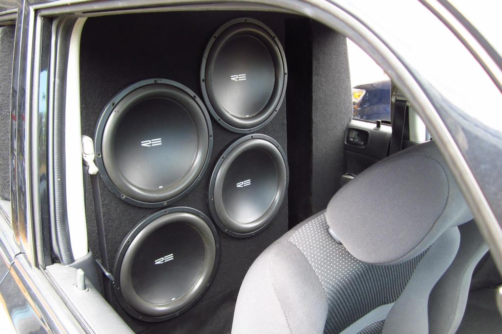

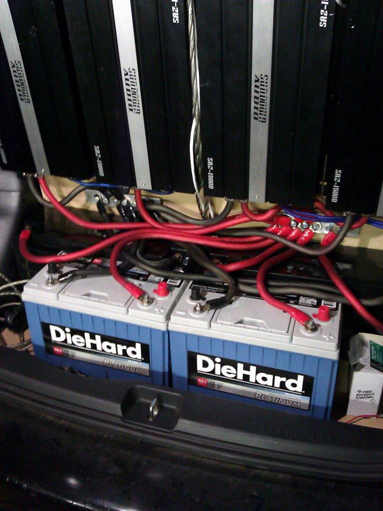

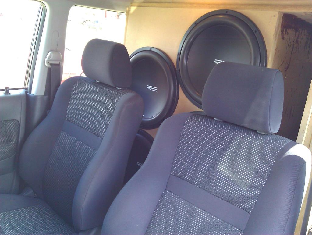

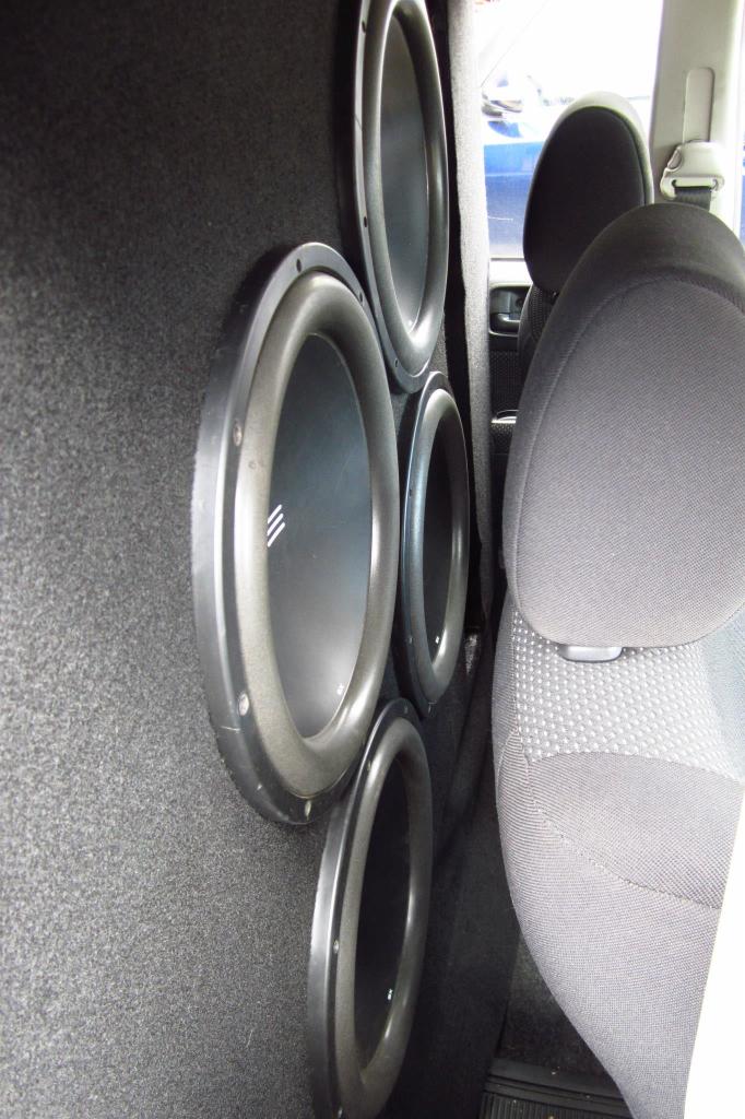

Hey guys, sorry for the wait, but here it is! Didn't take many picture during the build, since it was just me. Pictures are in no particular order
With the beauty panels in, I did a 152.3dB @ 35Hz, and I can do a 150.1dB @ 30Hz.
