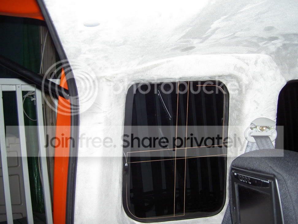

^^^^ if you want it smooth, it will need to be cut. for best looks it should be sewn back together.
if you want it as one piece, be prepared to spend some time with it. i drapped to suede into the piece so that there was 6inches of extra fabric drapped into the opening. working on the short parts (top and bottom) i glued it on in the middle of the peice. pushing the fabric to hide extra material needed for the shape. then i cut the opening and pulled it from the back side to remove more wrinkles.
work slowly from one side then moving to the opposite side.
it took me about 2.5 hours to do one. but i am not that experienced with this...
but enough to do it twice....the first time will be a learning piece.
this was the second piece i did...has a few small wrikles but still nice
It was cut and sewn back together. The shape of the pillar with my fiberglassed speaker involved and the lack of stretch-ability basically made it vertually impossible to do. I had a few guys that wouldn't even attempt it. Plus this wasn't your regular fake suede. This was heavy duty suede.
