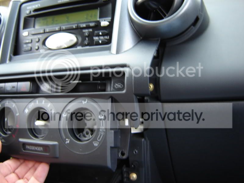

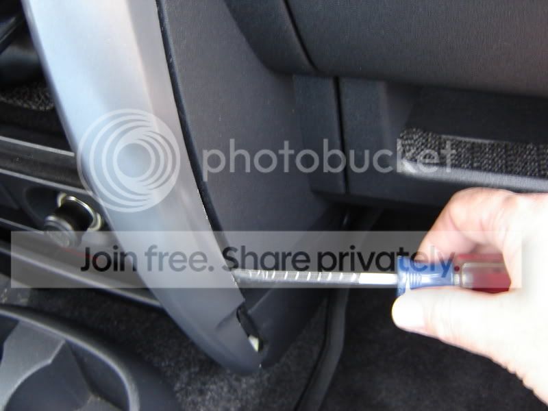

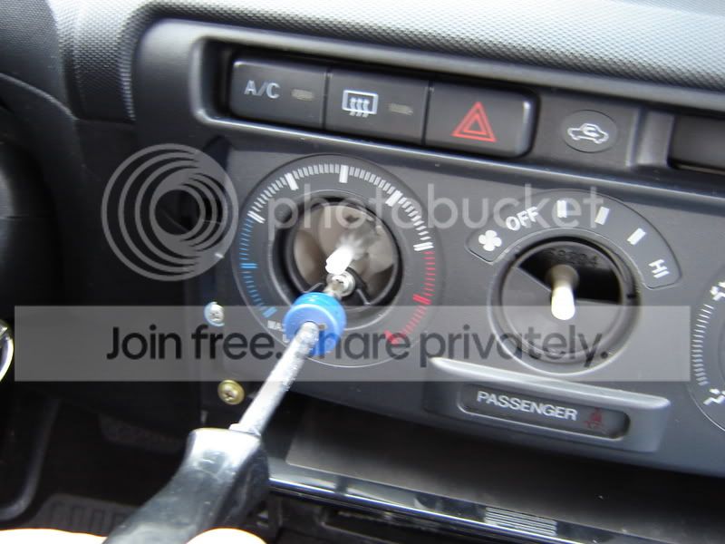

OK, this is easy...
with a flat screwdriver, gently pry the side spears starting at the bottom...press fit so its not too tight..
Then remove the 3 dial *****, and the 2 screws behind the 2 outer ones.
Then the 2 screws that hold the radio surround to the center stack,
and pull from the bottom to free it.....
Hope this is what you were needing.
