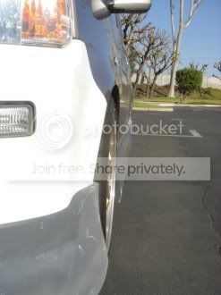

heres the pix of the positiv camber

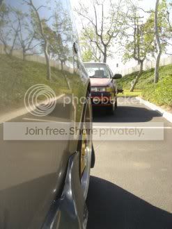

From: Cerritos, CA

i have this same problem.... ive been looking at several options to resolve this. I work on SCCA porsche cup cars on a daily in my auto body shop... and they use a low budjet method of hogging out the upper strut mounts holes. I really wonder if this method is good enough for SCCA race cars, would it be feasable on my box. Ive already ruined my fenders with my air ride/17x8.5" +25 offset works. this positive camber bugs the HELL out of me.
Old Mar 18, 2006 | 04:53 AM
Spider13's Avatar
Joined: Feb 2004
Posts: 1,881
From: Charlotte, NC (L.A.)
I've seen the lower mounts done that way to correct the problem. I considered it, but went with cusco plates so that I could maintain the space between the back of the wheels and the struts.
