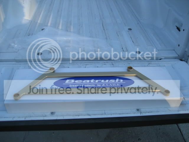

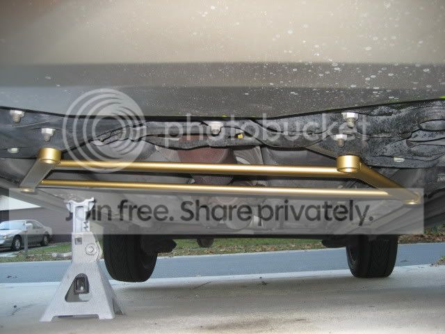

Yup ya guessed it!!! ANOTHER goodie from my good buddies at www.kamispeed.com i just recently put on the lower front support bar. http://www.kamispeed.com/product_inf...2925ba0e154bdc

not to nit pick here, even though i could be wrong. Don't you think its a smarter idea to install this frame brace when ALL 4 tires are off the ground?? When you lift your car from one side you get chassis flex (twist) and when you install a part like this, that is designed to keep your chassis straight (stiff), how is it supposed to work when is it bolted down when the chassis is twisted.
Its just my thought. Ive installed all my suspension parts with all 4 wheels off the ground. I use 4 jack stands and install on a level surface. As a i said i could be wrong, it might not make a any difference, but when it comes to chassis flex i do know a thing or two.

i actually put it on with it up in the air. i started to lower it and forgot that i didn't take an after pic. ^_^
