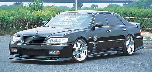

No beating around the bush: for looks!
Actually, it is true that some negative camber in most applications does help with cornering. And there is a misconception that camber kills tires; it doesn't. Camber coupled with bad toe in or toe out will. Toeing is what causes the car to drag the tire along the ground at an angle contrary to the direction of travel. So if you camber your suspension, but can assure that you don't have extreme amounts of toe in or toe out, then your tires won't wear any quicker than if they were set up normally. They will wear at the same rate, the only difference is that the part of the tire that wears is the inside and not the whole tire. In which case, you can then swap sides and run the same tires twice as long :)
But, the main reason for cambering in these extreme cases is to get the wheel/tire setup to fit under the fenderwells. True, not everyone understands or accepts the look, but the results are usually universally accepted: bad ___ wheel fitment that is super flush with the fenders. I submit:

Man I have always thought Junction Produce does a beautiful job with there work on there cars....everything is so clean
