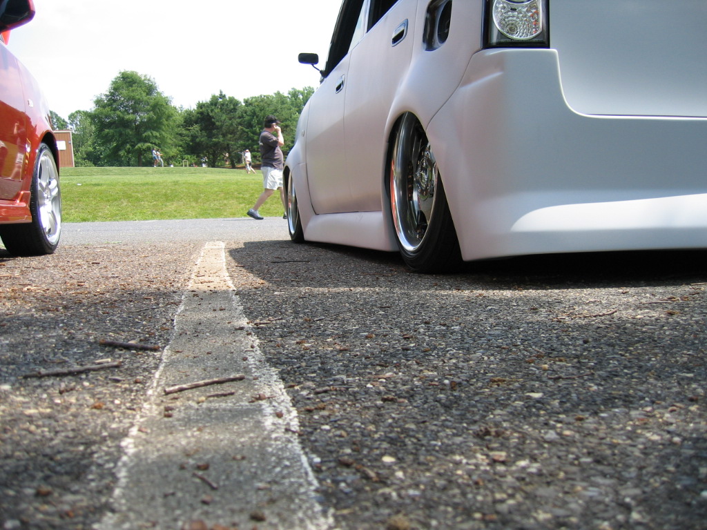

Im on ES front struts as well... and the tread was 1/2"x20. After tapping everything was simple. I dont even have mine as negative as the pics above, but my wheels are at -3.
heres a pic showin my camber front and rear...
>Mikey
