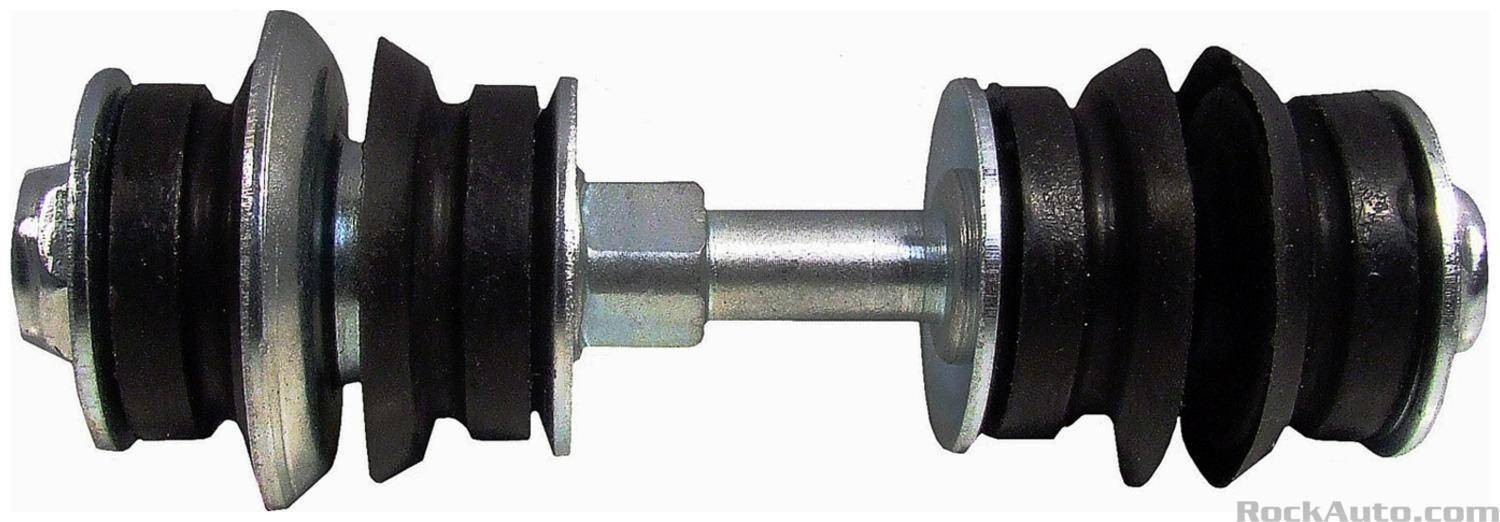

I reused the hub a few times but then got new ones when the threads on one got rusty. Also I saw you used the universal end links when I refreshed mine I used the same kind you put on and it they both made noise and I had to buy these oem style ones.
That's good info. I will keep my ears out for noise - what kind of noise is it? Clunking or something else? I am a little suspect of these links - they were like $2 each, even though they were made in the USA. Interestingly enough, the original bushing were made in the USA, which was a complete surprise.
I would say a pop kind of sound. Pretty noticeable if i was going slow and I drove over a speed bump with one side of the car or like turning into my driveway which has like a divot for water at the start and then it slopes up towards the garage

I got new hubs with the bearings so when it's time, I'll replace both and keep the old ones as a spare. Think it was a package deal. The mevotechs were a lot cheaper then OEM. The suspension links I got were from energy suspension. So far so good on those. If they last half as long as the original links, I'll be ok, plus they're kind of easy to replace so I wouldn't be mad if they went. If you do replace them, think about getting the Mevotech Supreme ones. Pretty good stuff and won't break the bank. Good luck!

I did every wheel bearing test I know of and it passed each one of them, so I'm not messing with it yet. I'll wait until it fails. I think I'm going to order a hub for when I do replace it. Definitely will check out Mevotech links if these $2 TRW links suck. Tires and alignment tomorrow.

Just a quick update - no issues and the sway bar end links are still quiet. New Yokohamas have been on for 1K miles and offer a way quieter ride. Heading out for a week long camping trip this morning.
Doing this front end refresh has really made the car feel new again. Drives straight, everything is tight and can't be happier. I highly recommend doing this job at one time if you have yet to touch anything. It just make sense now for these 18-20 year old cars.
