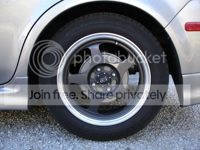

Busy weekend. I went about powdercoating my drums and calipers and caliper brackets. A friend of mine has a powdercoater so I made a trip to see him this weekend.
My oh my, we underestimated the time required to clean the old brakes. To powdercoat, and expect a good finish that will last, the surfaces must be completely clean. Had I not previously painted the same components with the Duplicolor kit, it would have been a breeze. The real kicker was that the paint was flaking in spots, and was inpenetrable in others. We did have a sandblaster at our disposal and even it was having a tough time. Also, the high temperature powder requires the parts to heatsoak for an hour then cool prior to coating them. So all told, it took two guys about nine hours to powdercoat and bleed the brakes.
The finish came out amazing, and kills the red that I used to have. It goes with the car much better.
Also, today my drilled and slotted rotors came in, so I threw them on after work.
And now, pics! More to come of the car when I clean it up.

Thanks everyone, and yeah, it's amazing how light the wheels are, even with tires.

nice.....now what kind of pads and how does it stop?

Toyota pads and it stops quicker and the pedal is firmer, but not by a significant amount.

Off subject - Max -
What size are those Rota's and are you lowered at all? Do you have a side pic to see how they look in our wheelwells from full car view?
Thanks in advance...
And those brakes look amazing. We need to find someone that will make a cheaper rear disc conversion. Then you would be set!
wombat is offline
Old 04-19-2006, 05:04 AM
Max
Max's Avatar
Join Date: Dec 2004
Location: Atlanta, GA
Posts: 4,971
Originally Posted by wombat
Off subject - Max -
Rotas are 15x6.5 - stock tires. I am sitting on Hotchkis springs which claim about 1.5" but end up a little lower. Better pics of these brakes to come - probably this weekend, but until then, there are a couple pics in my profile with the red painted brakes.
