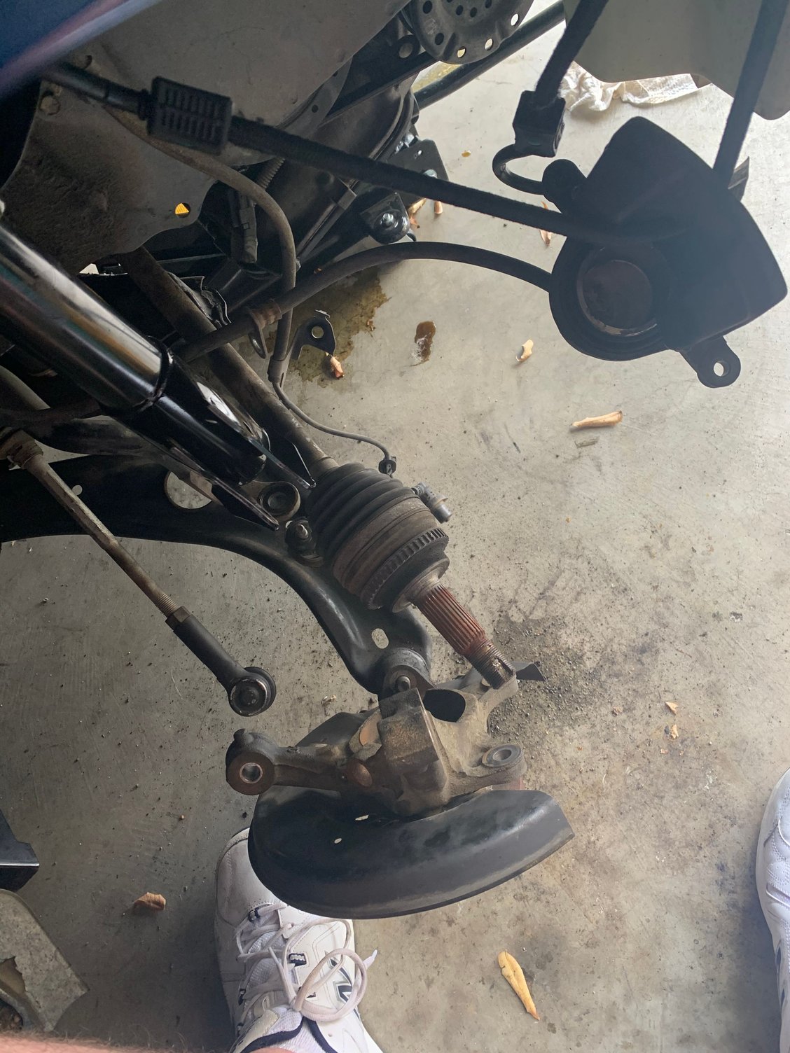

For me I got my start with needing a car and then the xA was sitting in front of a family members house I ended up doing some work for them , Long story short the car would barely start and stay running, 205,000 miles at the time? We charged the battery called triple A towed it to my old house, did a shake down after swapping to a new battery it’s still running the stock alternator id have to pull it to know for sure but the interior is practically mint broken stereo , one plastic piece to lift / lower the back seats broken too other then that no stains or tears , I put new spark plugs and replaced some of the worst oil I’ve seen in my life and I’ve worked on 10,000 mile oil changes +
I swapped the entire front suspension still need to replace Tie rod bars and one of the ends, the rear I only have struts (everything else original) but the car is super bouncy rn so I think it’d help to swap them , it’s leaking power steering fluid pretty bad I have the pump but I think I’ll drop the sub frame to make it easier because I think my timing chain is loud af rn but I’ve heard worse , I have really bad piston slap when it’s cold , i think it knocks at low rpm at least noticeably, transmission feels really smooth for 15 year old fluid gonna do it when I drop the motor for rebuild, it’s a basket case but it runs nice after 1st gear.
This control arm came off no problem
This ones ball joint had to be sawed off and I hammered out the stuck pin
OEM vs Moog? I think also Moog’s sway bar end link kit sucks I had to buy ones from Napa which were a world of difference

I ended up with something similar from CARiD or car parts.com and they clunked all the way to the Napa store, I swapped to Napa versions where instead of a brass bushing
the center piece is solid and instead of a long bolt it’s double threaded it costed $50 and made a huge difference maybe it was how I installed it or something but this one doesn’t clunk.
