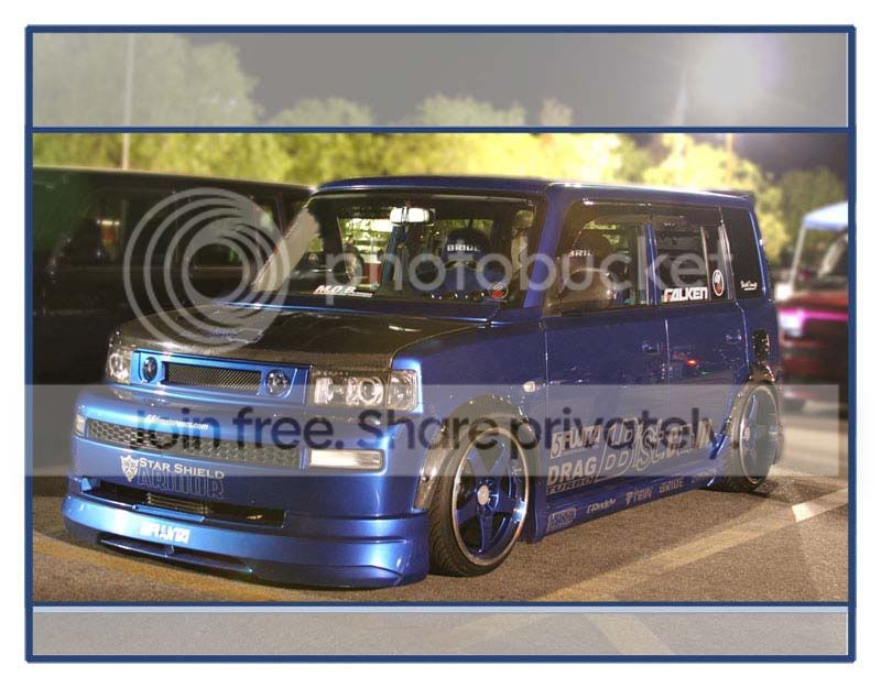

The main thing you will have to do is put the flares on the car and measure how much you will need to go wide.
Decide if you are willing to cut up your car for clearance or you WILL rub! We measured what we thought would clear and our xB was rubbing like crazy and popping off the rear flares. Each manufacturer makes flares that extend beyond the factory fenders at different lengths.
It looked pretty goofy when we adjusted the coilovers for clearance because we didn't want to cut up the box. Ultimately we decided to cut up the body and go with the Air Runner suspension system.
For SEMA we ran a 15X8 0ET wheel and the fronts stick out about 1". With the same wheel, the rear's stick out about 3/4"
Here is a pic before we cut the body for clearance (at this height, the rear wheels still rub)
And here is a pic after we cut the body for clearance...
Good luck with the flares! Post some pics when you get everything on!

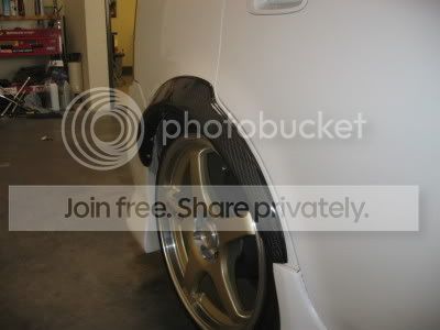

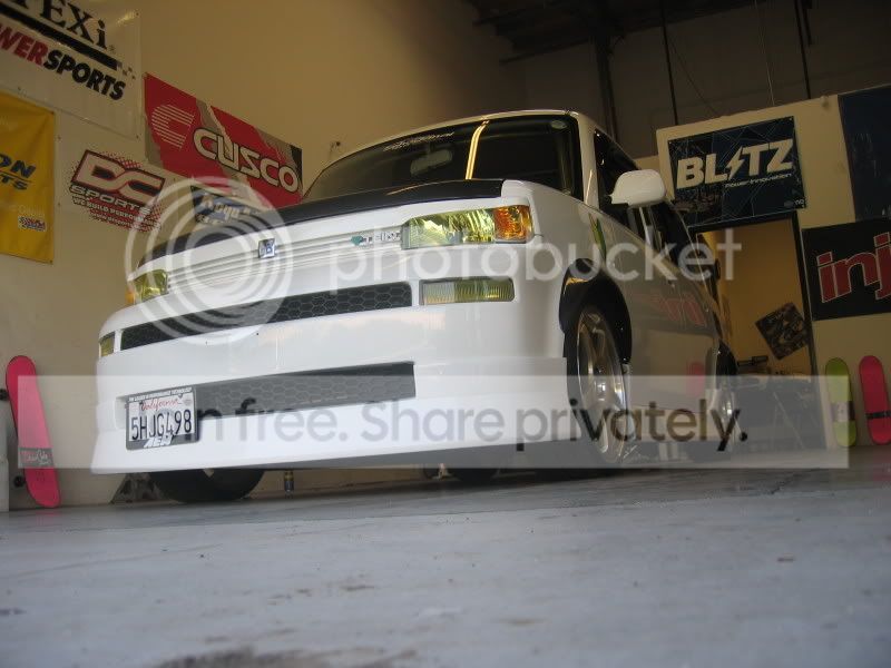

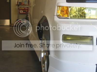

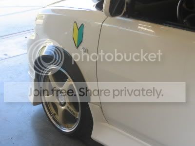

Old Nov 14, 2005 | 03:09 AM
cassidy's Avatar
Joined: Apr 2004
Posts: 173
From: Simi Valley, CA
here's some pics with my flares on
