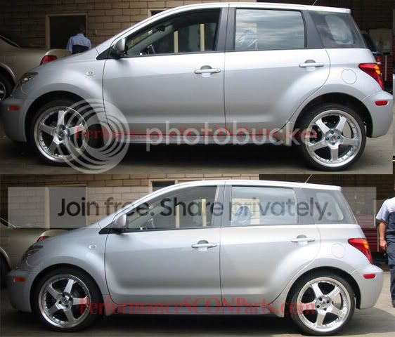

Old May 26, 2005 | 03:08 AM
NISMOZ33's Avatar
Posts: 148
Yes... That is an xA on S-Tech's on 18's...

Old May 27, 2005 | 01:02 AM
NISMOZ33's Avatar
Posts: 148
38mm wont rub the fender thats for sure...
3mm further in depending on the tire size you get wont rub but it will get close...
The wheels on my girls xA (pictured) are 35mm offset...
You could run a much lower offset on the xA / xB but unfortunatly with the 4x100 bolt pattern there isnt much available :-/
