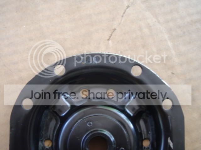

Thanks for all ur help. I just called my local autozone and they said that they do "rent" out spring compressors with a $40 deposit that i can get back when i return them. Just to get everything straight before i go replacing things i posted a picture from the spring replacement thread:
As i understand it the orange thing is the foam like gasket and the piece of metal that it's stuck to is the strut bearing. The piece that the guy is holding is just a metal plate and below that is the strut rubber housing. Please correct me if i'm wrong and i apologize for my noobness , but i guess we all gotta start somewhere. Thanks.

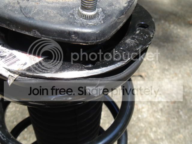

Ok everything apart today and discovered something really strange. The metal plate at the top of the strut that turns was actually rubbing up against the body of the car. So when u turned the wheel the top part of the strut didn't actually turn. Then when finally the torque was too great it would all of a sudden slip, and because the strut was actually touching part of the body of the car the sound was amplified. Here are some pictures to explain.
Here is the passanger side strut right after we took it off. I don't know if it's just me but to me it looks like it was a little off center.
What was more surprising was that u could see rub marks on the metal plate of the strut. This is the passanger side strut.

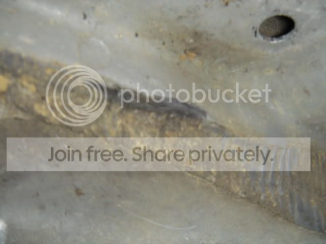

Here is a picture of the wheel well where u can sorta see where the strut was rubbing up against the body. I know it's not very clear but couldn't get a good pic taken.

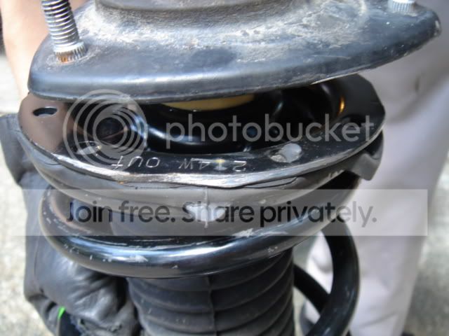

Although it wasn't as bad on the driver side there was also evidence that there was rubbing. This is the driver side strut. The metal plate was also not installed complete straight. The side marked "out" was actually more pointed toward the front of the car.
I don't really know what caused this rubbing but to solve the problem we took the strut apart and ground a little bit off the metal plate so that it would no longer rub on the body. Kind of a half ___ solution bit it worked. Please let me know if anyone has any possible idea what might have caused the strut to rub up against the body like this. I did by the car second-hand, we were thinking that maybe the frame got bent or something. Or maybe when the guy had the struts replaced he put on the wrong ones. Or that they just weren't installed properly and i actually didn't need to grind down any of the metal plate just reinstall it properly. Anyway the problem is now solved. No more thuding when i make turns. But any input on the underlying reason for the rubbing would be greatly appreciated.

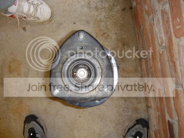

Here's a pic of the metal plate after we ground it.

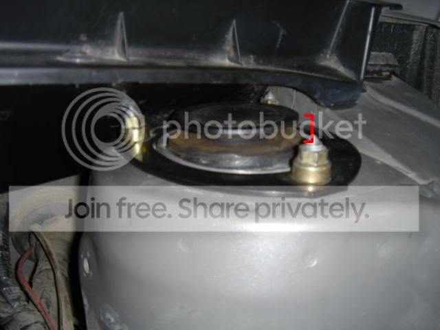

Also there is a gap at the top of the strut. I had noticed this even before i took everything apart but it seems like the gap disappears when i took the strut off. It's the same on both sides and i don't understand why/how it's there.
I guess what i'm really asking is if anyone can explain to me in detail the structure/anatomy of the strut and the 2 issues that i don't understand above. If there's a webpage or another thread that you can point me to that would be great. Thanks in advance.
