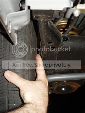

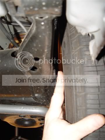

I have some 15X7 Konig Rewinds with a +40 offset. The stock 185/60 15 tires are on them I was amazed how little clearance I had from my rear suspension. This picture shows that I couldn't even fit the tip of my index finger between the rear suspension and tire:
I put on One ton Garage spacers:
Now I have about 15mm clearance instead of about 5 mm. I can't believe how little clearance the stock tires had. The OTG spacers are very high quality and not very hard to install:
Clearance after adding spacers:

As you can see in the pics posted above, 15x7 +40 gets pretty close to the suspension...so 16x8 +35 would be even closer by 7.7mm......
