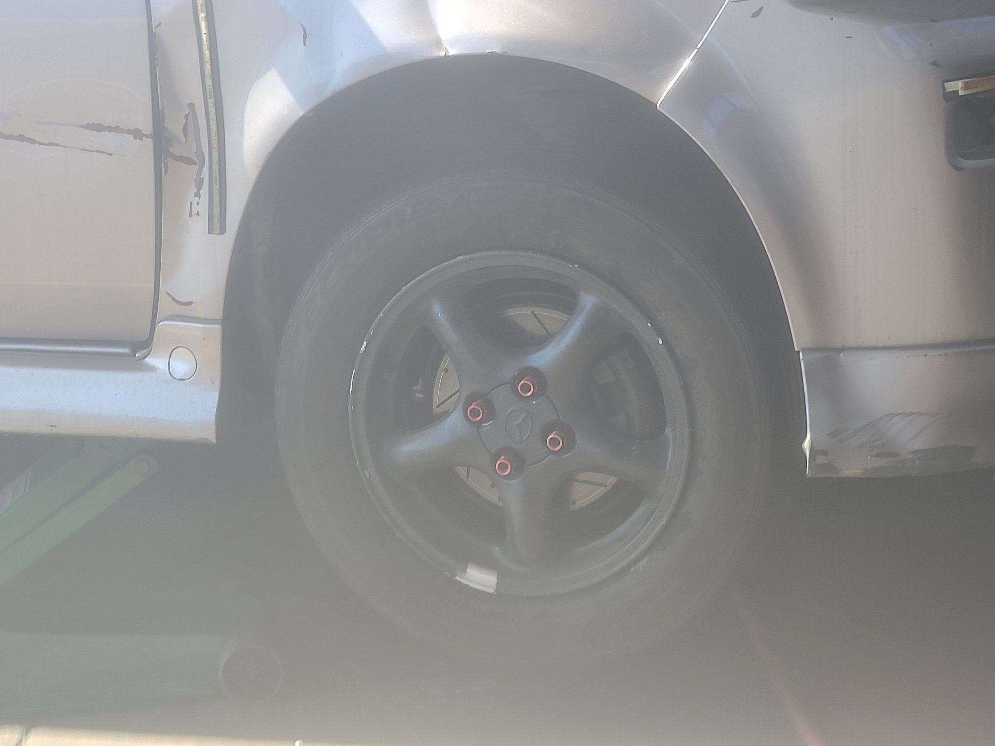

I have ran all different sizes on my xB. 175/65/15 , 185/65/15, 185/60/15, 195/65/15, 205/65/15. The 195/65/15 on stock steel wheels was by far the best ride and gas mileage. I am running 205/65/15 right now but there is rub on the front at full turn. The all seasons are little more meaty on the front. Which is why I think I have rub. But I live in a place where snow is a problem. So I will deal with it till summer. Speedo is off by 2 mph but the ride is amazing. No issues on the rear. But come summer going back to 195/65/15 hope this helps someone cause I had problems finding anything on this subject.

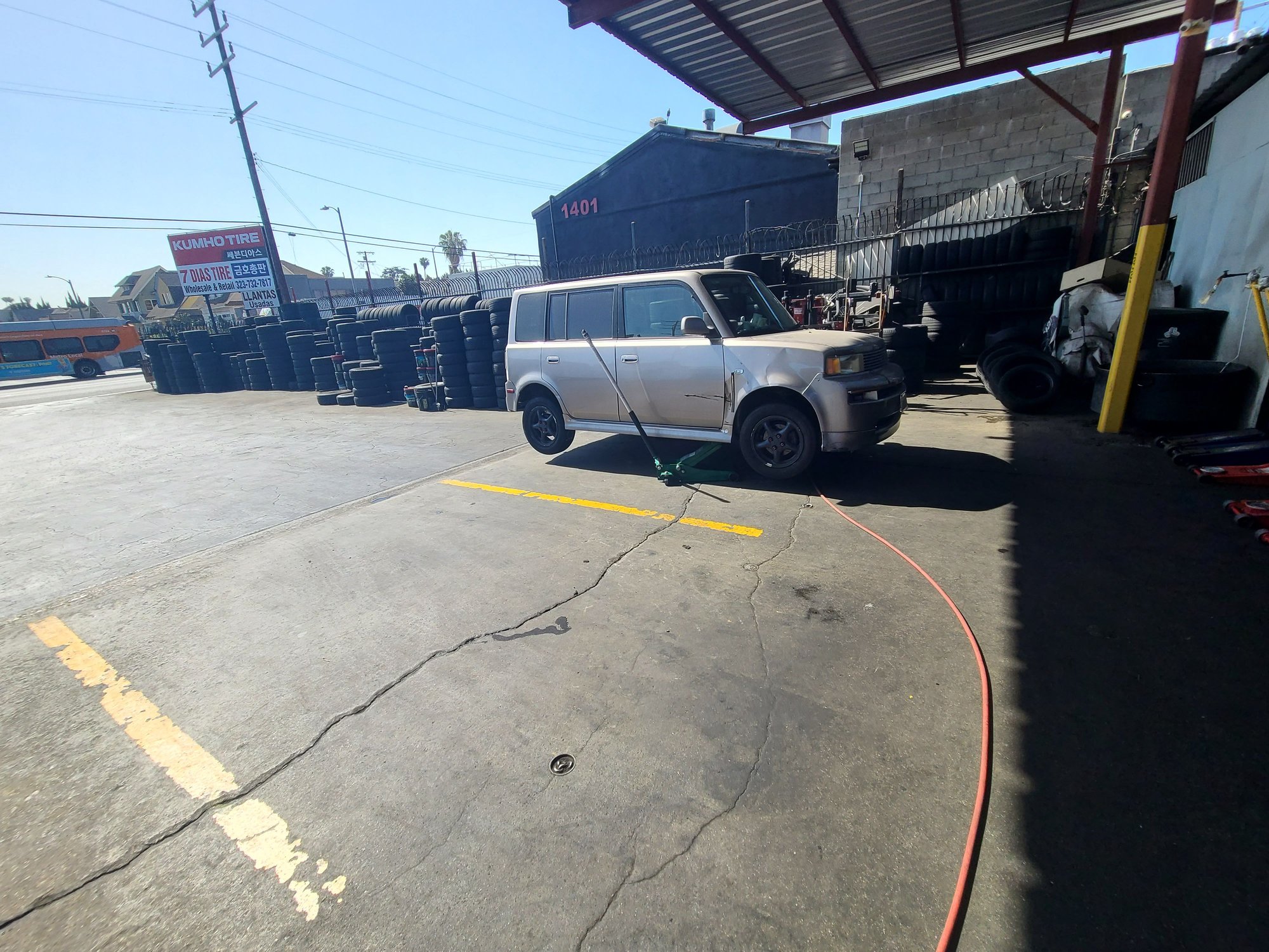

Default Yes works perfect also raised 1.5inch, no rubs when turning
[QUOTE=saicow;489805]Does this size fit? or rub when turning? People have an idea about this, but I need someone who has actually done it.
Anyone with a story out there? Thanks for any useful and specific info.....B
Yes
i own a 2004 scion xb with 240k miles 5 speed manual 1.5lts (1st gen) and rides on Bridgestone ecopia 195-65r15. No rub when turning no tall shocks everything factory specs
