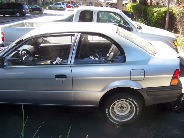

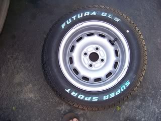

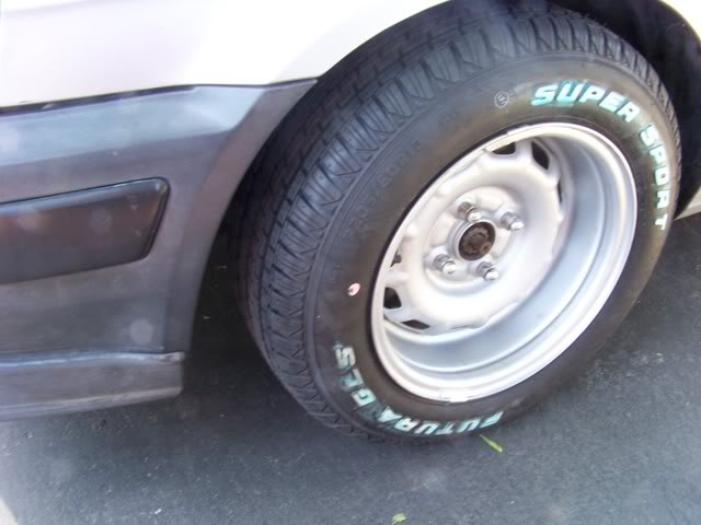

not on a tercel but widened steelies non the less...
I grew up in the 80's and I've always loved subtle looking steel rims with white letters on cars like this one posted by THTCUWT, thanks man!
I hope other 80's car lovers get a kick out of this.:2thumbsup:
Now here's more of my puppy

The wheel dimensions are 13x7 with +6 offset and 4.25" back spacing, so no inner rubbing. I drove on it on the freeway and ran it on speed bumps and pot holes and it there was no fender rubbing, albeit I expected some since the wheel goes .5" out of the fenders... I like the look so far so I don't think I will slam it down. I am pretty much just gonna keep an 80's theme with a lower front end, but not to low, and probably have the rears close to stock height.
This is not a complete set yet because I wanted to make sure the fitment was perfect... and now I know so I'll be getting the rest of the set made within 1 or two months.
