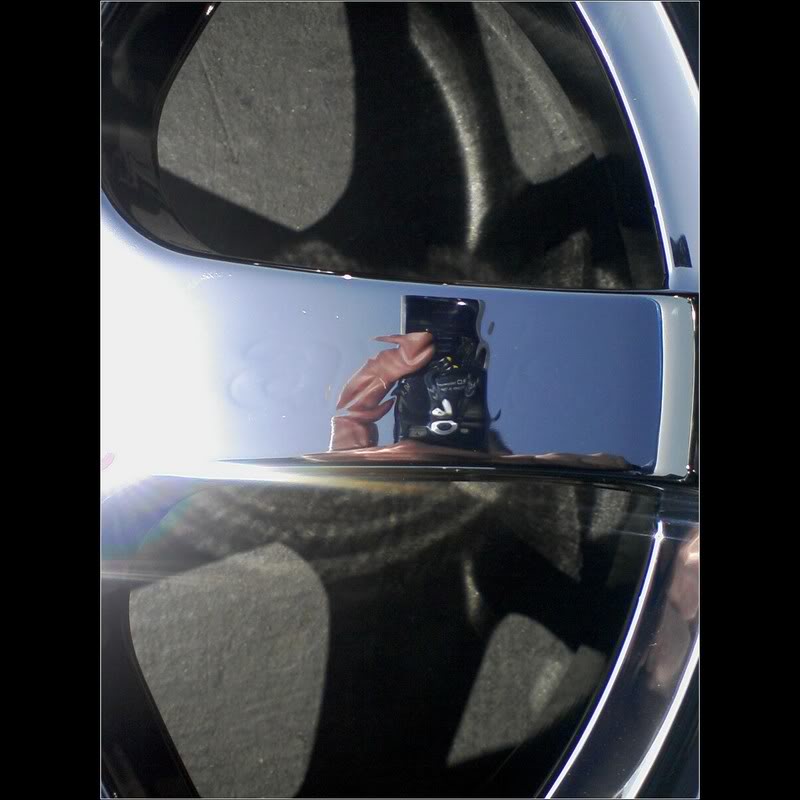

Old Jul 18, 2009 | 06:32 PM
buzzwyzr's Avatar
Posts: 132
From: Colorado Springs, CO
I concur with 2Black2Box and hip_2b_sqr. The 90/120 combo fits a-ok with no spacers or rubbing issues.
Here are a few pics. I wish I had better ones, but the box is long gone, and the wheels are longer gone.
