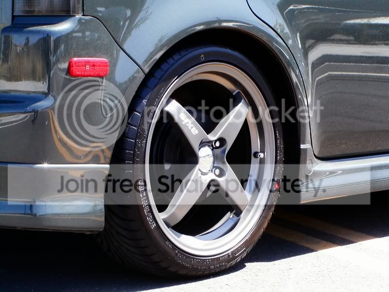

It all depends on what you're going for. My wheels are a +40 offset:
These are a -32 (Yes, that's MINUS 32 )
See how most of my rim is under the car and behind the hub. The other ones are going to have much more of the rim in front of the hub, sticking outward. Of course they'll be tucked under flares and won't just "stick out"...
Does that help?
