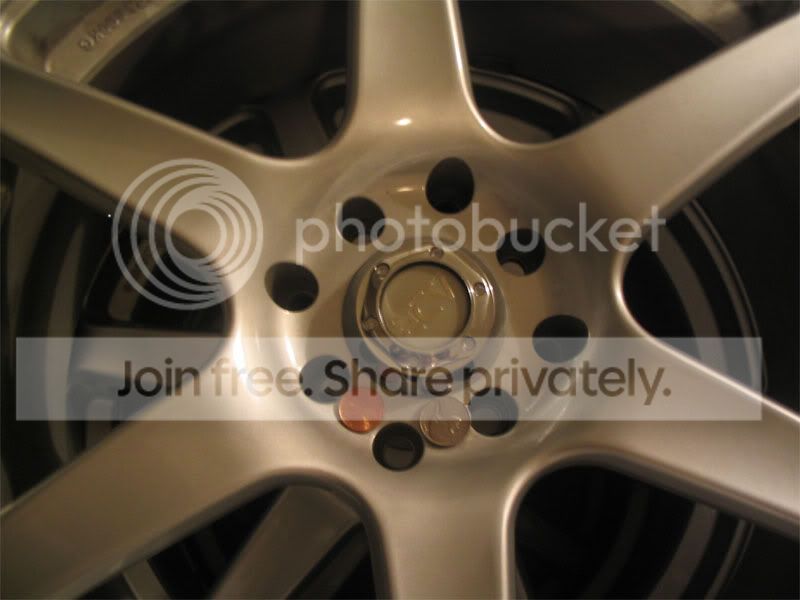

haha i use to have ADR's.
hopefully this will help u in determining the size.
Old Feb 14, 2005 | 03:39 AM
pharynx's Avatar
Posts: 388
From: Buena Park, CA
Haha, looking good. BTW, appreciate your help in coming to my house ray A very good source for problems I'll be going to a shop near my house earlier tomorrow to see if they have yet to find the right size lugs, but either way give me a ring tomrrow about that island motorsports (?) and their lugs
