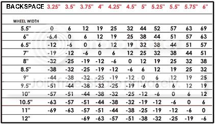

Here's a backspace to offset chart.
Also, how to calculate:
* First, measure the wheel’s backspace
* Measure the wheel’s overall width from outside rim edge to outside rim edge
* Divide the wheel width figure by 2
* Subtract the resulting figure from the Backspace measurement
Example: If the backspace is 3.5 inches and the total wheel width is 8 inches, then:
* 8 ÷ 2 = 4 inches
* 4 – 3.5 = - 0.5 inches – the Wheel Offset (a negative offset)
Then you just have to convert inches to mm.
To convert from inches to mm multiply by 25.4
That should get you pretty close.
