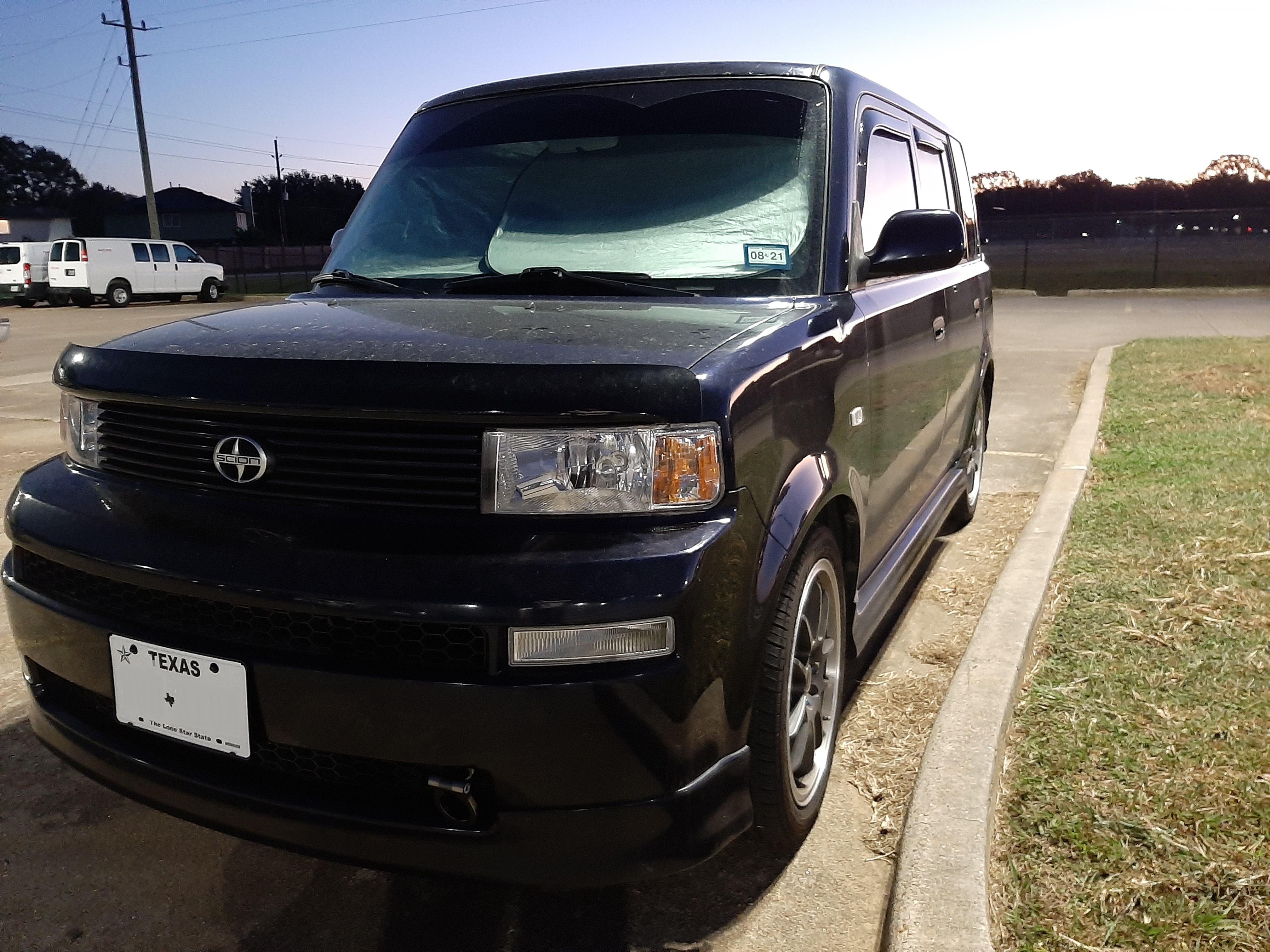

Mine had 17" Enkei's with 215/45/17s at stock height when I got it. Haven't changed anything. No rubbing, not sure of offset.........
Attached Thumbnails New to Scion Life! Will I rub with anything bigger than 205?-20201117_062430.jpg

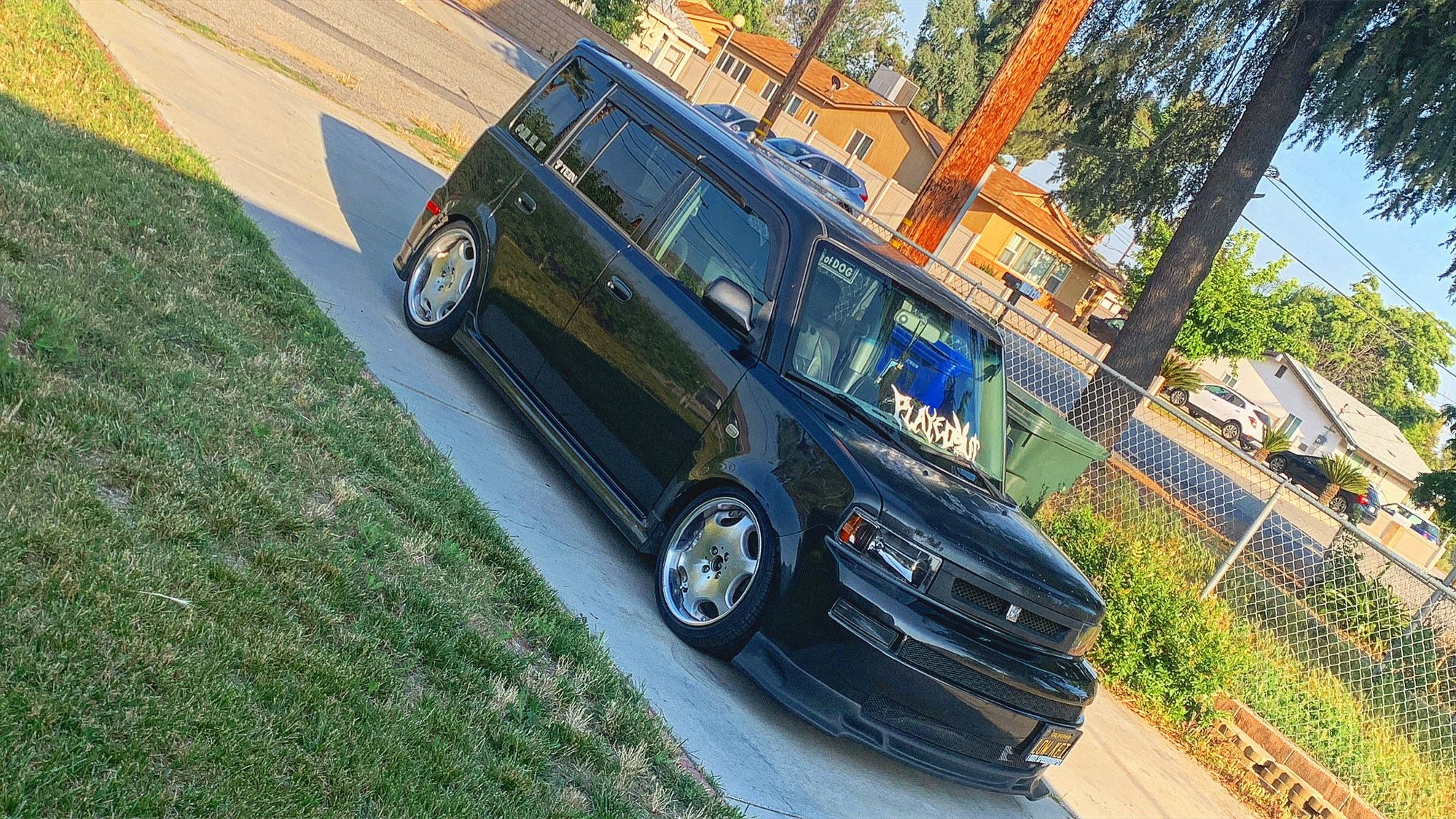

205/40zr17 on 17x7.5 +35. Rolls lips and minor pull, no rub and I’m dropped on Tein Street Basis Z’s, maxed out in rear and front is dropped even. No rub
