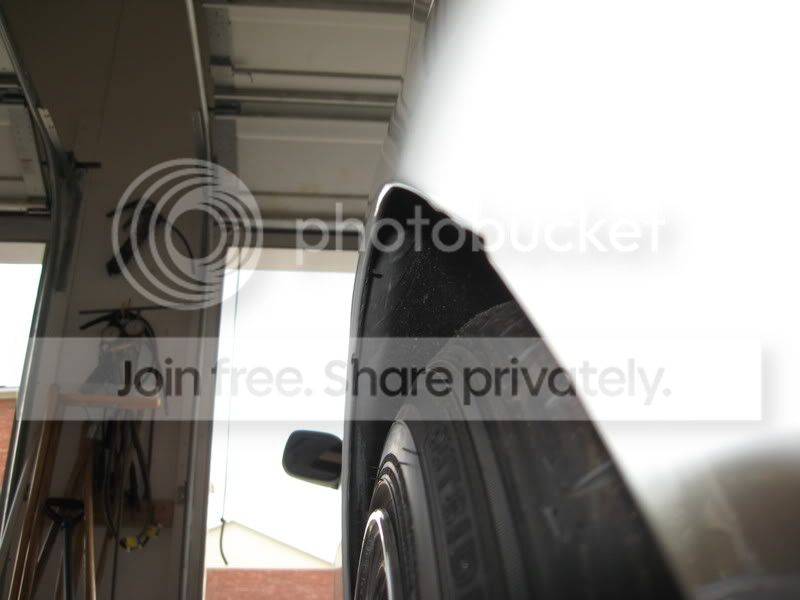

ok........... let me give you a break down on what i went threw with the +15 offset set up.
i have the black 16x8 15 offset with 195/50/16 falken 912
when i first put them on i had s-tech springs with 10mm hub spacers and the back rubbed so bad i had smoke comming out of my wheel wells, the front is not an issue, never has been.
first off the hub spacers had to go.
i took everthing out of the back and it went away for the most part. about a week after that i installed my Tein SS coilovers so i was able to rase it up a little untill i put my -3 camber on.
even with that ............ at hightway speeds i would still rub a tad bit every now and then.
so i gat a Eastwood fender roller off ebay, used it and then just turned around and resold it, i only lost like $50.
i no longer EVER have any rubbing issues
this is befor camber with out fenders rolled, with nothing (and when i say nothing, i do mean nothing, no spair tire no storage bin, nothing) in the back and noone in the car
the next 2 is with camber without fenders rolled, alos "nothing" in the back and noone inthe car.
and thease last pics are with the fenders rolled
and this is with "alot" of stuff in the back & driver + 1 passenger
no more rubbing, "EVER"

You keep mentioning 16" , i'm going to be running 16"
I ran a 16x8 0 offset with the tanabes and under load 3 people rubbed
i hopefully will be fine with the 15x8 and 15 offset
15" w/ 195/50/15 is 22.67" diameter
16" w/ 195/50/15 is 23.67" diameter
so (simply) 16-15 = 1"
Old Aug 20, 2008 | 03:40 PM

i know your runnin 15, i was just tring to show what the deal is with the offset.
the other thing to consider is a 195/50/15 is a full inch shorter then "stock" size.
When speedometer reads 60mph actual speed will be 57.4mph, 4.3% slower.
it will also lower the car a 1/2 inch + your MPG and your ODO will be off
for your ODO......... when you have gone 10k (acording to ODO) miles you will have only gone 9565. so the ODO will be showing more miles then you realy went.
im not tellin you what to do.
im just giving you facts and showing what i went threw to get were im at.
this will make your car apear to have more miles on it then it realy does.
