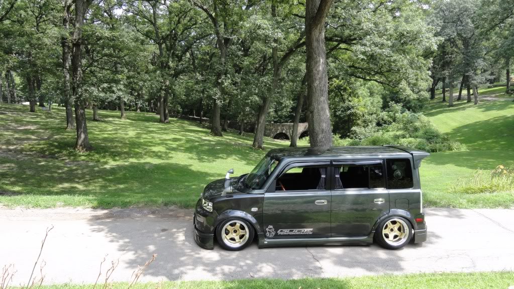

Im planing to buy a new set of rims for my 05 xb. Only problem is what size i should get it. Im thinking of either 16x8 or 16x7..and the type of rims im going to get is either drag dr20 with a +10 offset..or axis oldskool..i know that dr20 come with 15x7 or 16x7..which 1 would look better? And axis oldskool comes only with 15x8 with a +25 offset..which one do u guys think would look sick? I really like the axis oldskool but im not sure if 15" is too small for my car..and im not sure if i should get the 16" because im scared it might rub..oh by the way im planing to lower my box with tein coilover kit..so does any1 have any great suggestions?? Thnx

Either will be fine. SHouldn't rub at all. Here is a pic of mine on 15's. 15's look fine if lowered, but not on stock height.

oh and what he said either will work and you really torque down the coils as needed
