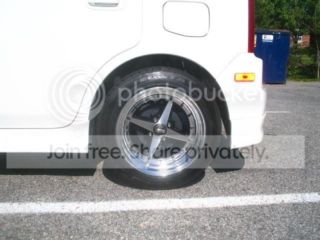

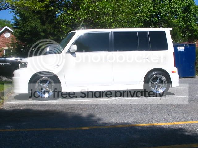

Not sportmaxs, but these are the same size 15x8 (if you were planning on getting them) and this is w/ TRD springs/struts. I bolted these on a few days before putting my coilovers back on this summer.
In my opinion you should go lower. I thought my car looked ridiculous like this.

Offset? Tire size?

read my profile.
front is +25 A disk, rear is +10 O disk. Tires are 195/55/15.
In those pictures though I still had OTG rear spacers on the car. That would put it around a 0 offset which is what the 002's would be. Thats why I thought I should show you these.

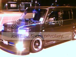

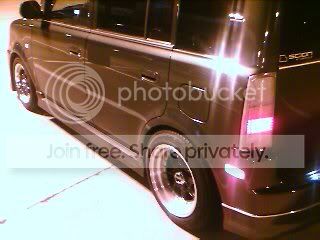

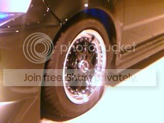

Here's my setup:
2" drop all around using Tom's Lowering Springs.
Front: 15 x 7 +38 offset
Rear: 15 x 8 0 et
I rub a little in the rear considering my drop. I had to roll my rear fenders but other than that I love the way it looks. Here are some pics:
BTW: I live in the DFW area also.
