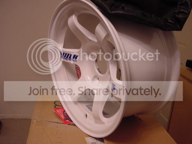

Old Aug 24, 2004 | 06:16 PM
the_saint's Avatar
Posts: 640
eh, I was thinkin' more along the lines of this!!
I think I'd sleep with these wheels if I could
OK, well, maybe I'm not that extreme, but I'd probably name each one....Marie, Helena.....
