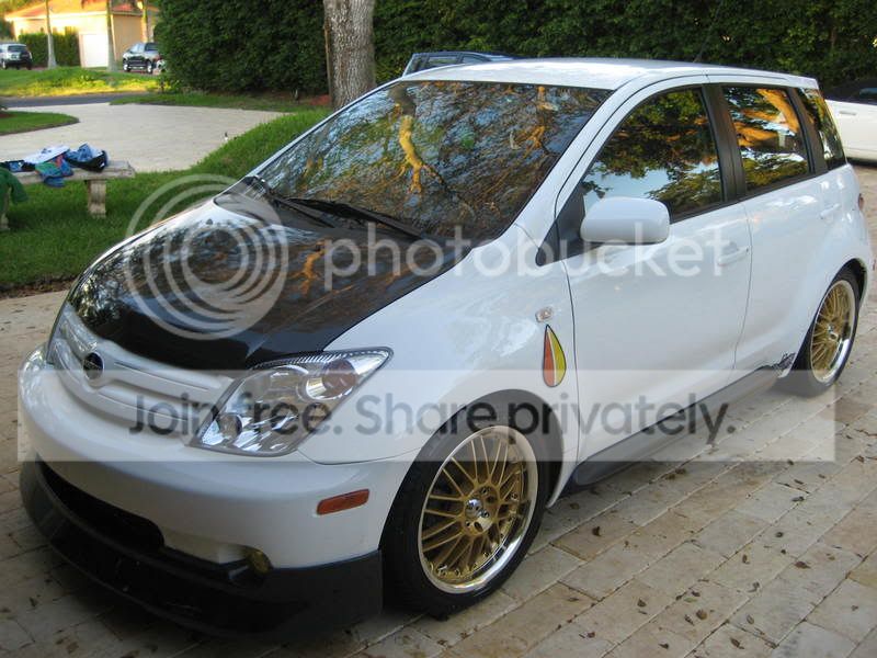

ok guys. so if all goes well, my wheels will be painted this weekend! now, i was all set to paint them orange, but i have everyone telling me to stay with gold. here's a pic of my car with gold now. my new wheels are different, and imo, better. lower offset, about 4 lbs lighter per wheel, and a very simple style which i think will look sharp on my xa. it's the flik ftd btw (gram light knockoff). which color should i go with? i'm prepping everything tomorrow and painting sunday. i'm definately in love with the whole orange idea but should i mess with success just to be different?
here's my car now.

smokeydog001's Avatar
Posts: 617
nobody has orange. why not be different? if it was mine, i'd consider white.
Old Oct 6, 2006 | 08:35 PM
randomsuper's Avatar
Posts: 2,105
From: Miami, FL
i considered it, but don't like white on white unless it's a pimp looking ride. my car is anything but pimp.
