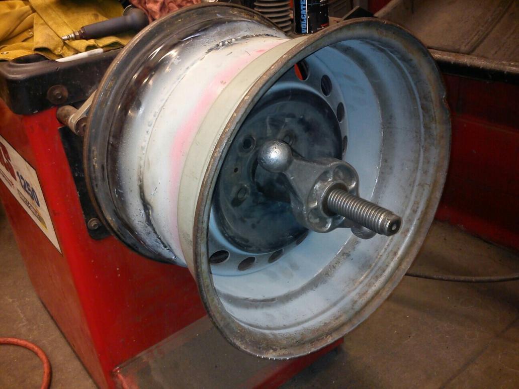

I'm currently making a set of 15x10 Steelies I'm using the stock steel wheels and a set of 15x8 Chevy rally wheels. Since for the back side I used the stock wheels there should no need to change anything. I'm almost done with the first wheel I'll keep you posted as I go.

Maineman, how are you keeping the wheel true? Very interested in this, the only local shop that widens steelies quoted me 360$ per wheel for rebarreling!
