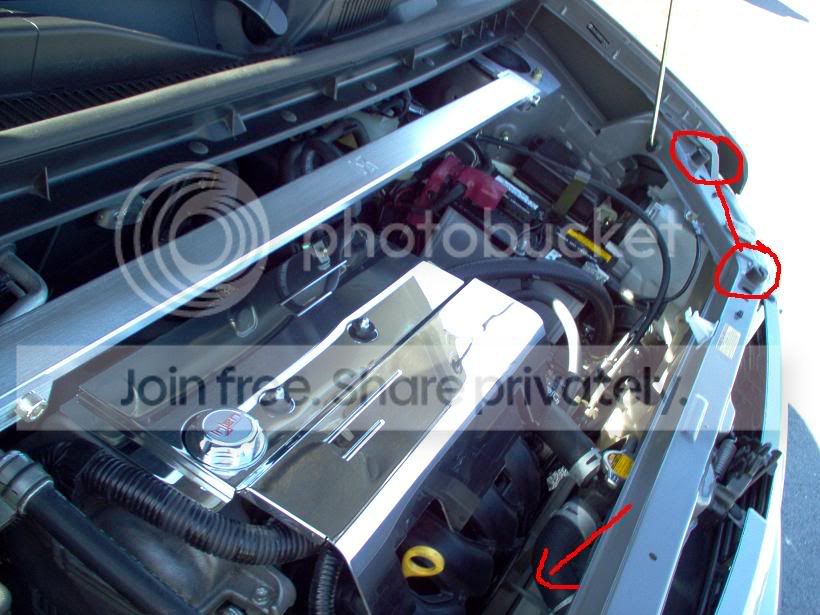

Use 2-3 people...its really simple took off your stock hoods and washer parts...have one person on each side holding it up and wrench the new one in. IF you have a fiberglass shell do not tighten it too much because you can f up the fiberglass...as far as getting it straight on mess with the 4 black tabs which help adjust the hieght of the hood for each side...

Where are the 4 black tabs you speak of? The hood does not appear to fit. The latch hoop is slightly off center and prevents the hood from fitting into place when latched.

well if the latch is messed up there are problems...you try drilling new holes for the actual latch but really try adjusting the black plugs...here is a pic...there are two on each side

hey that pic has the strut tower brace, i always wondered...can that be installed easily yourself? or does it involve a lot more work since it is connected to the struts?
